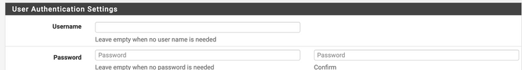

            Did you set them here in the client configuration?

              @Strive2Learn said in OpenVPN Credentials Manual Console Input During PFSense Bootup?:
              It is the ProtonVPN credentials that I'm required to enter in the console and that I would like to save locally on my PFSense box so as to NOT enter them every time at PFSense boot up.
              I've configured a ProtonVPN config myself. You don't have anything to enter at bootup, that would make no sense at all. So I assume you just forgot to enter them in the fields @Derelict posted above?

                I have entered the protonVPN credentials in the webconfigutator under VPN/OpenVPN/Clients/Edit (WAN) as depicted by Derelict. I know the credentials are correct because the connect to protonVPN works when I enter those same credentials in the console! The credentials remain on the Clients/Edit webconfigurator page when I restart the router. The password field is filled but truncated with ****** shorter than the actual password which I assume is a security feature.

                  You should not have to use any custom options to get it working. I would remove all of those, looking at them, and put the username and password in the appropriate fields. You are not setting the username and password anywhere there, so it is prompting for it when it starts.
                  Many walkthroughs and much documentation have you putting all kinds of nonsense in custom options that should be in the configuration fields instead. That way the pfSense configuration knows about them and can try to do the right thing as OpenVPN makes changes as time passes.
