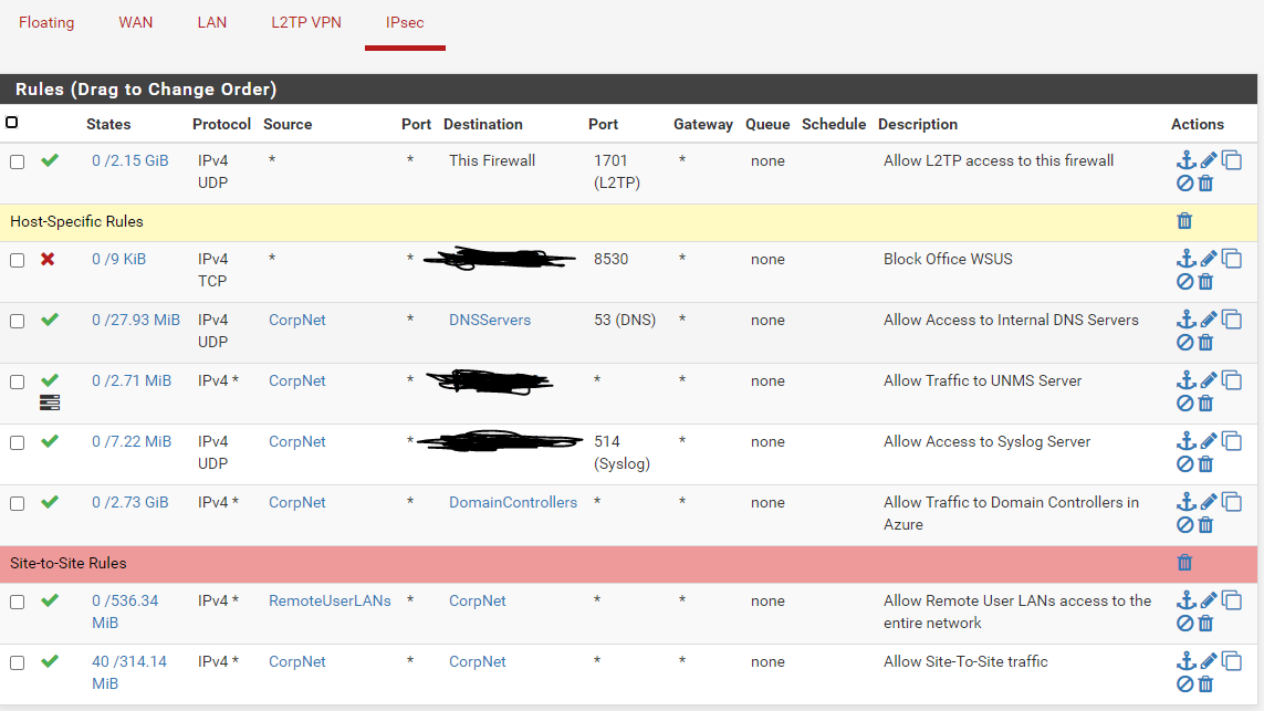

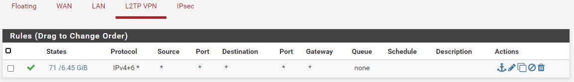

            As promised, here are the images of our Firewall rules.
            IPSEC:
            L2TP:
