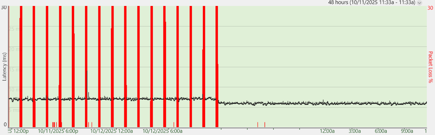

                        I tried using it for an online game and was noticing that I was getting dropouts for 15 minutes about every hour, so I just went back to using ipv4. This weekend I started looking at it more closely and found that every 1 hour 15 minutes, I would lose the ability to use ipv6. These are the entries I would see in my logs. The period from 9:52-10:04, I would have no ipv6 connectivity. IPv4 would renew the leases fine and connectivity there was unaffected.

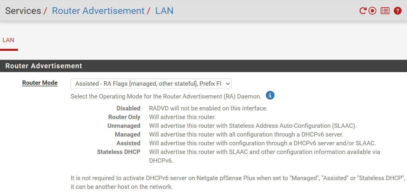

                        Ultimately, all I did to "fix" this was to disable the KeaDHCP service on my LAN interface and change the Router Advertisment-->Router Mode from Managed to Assisted and let my clients sort ipv6 themselves instead of having the router do DHCP. I could set it to Stateless but if someone can tell me what I was doing wrong I'll try and set up DHCP6 again.

                        Since making that change, my ipv6 dropouts ceased. Also, an unexpected 1.5-2ms reduction in ping time to the target I was using.
