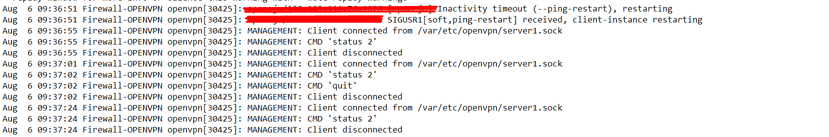

      my users sometimes disconect from VPN, the message in the server is:
      these problems are random in the users.

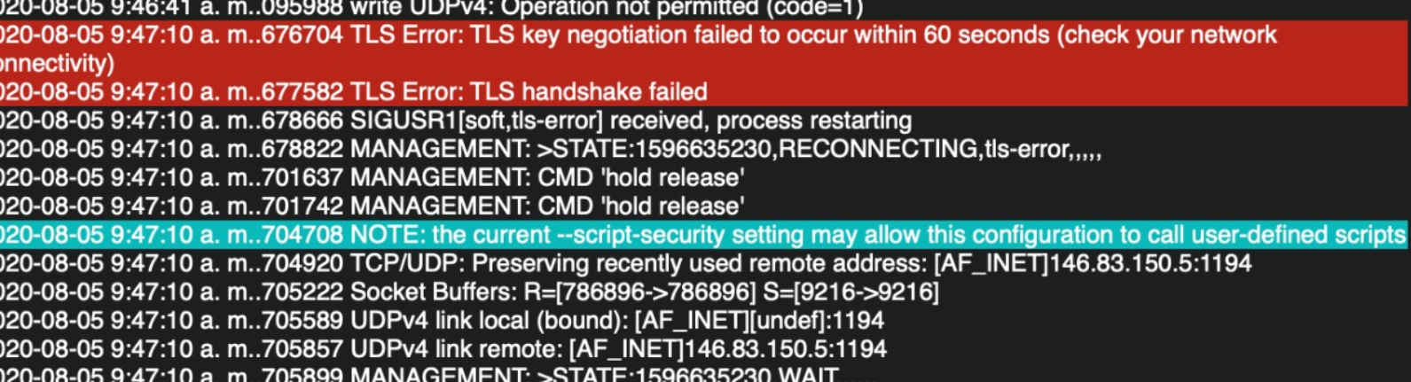

      the message log user
      i don´t have multiwan in the config only one IP wan and lan.

        @jalvarez-s said in Problem users disconnect Open VPN pfsense 2.4.5-release:
        Check the options in the description:
        https://openvpn.net/faq/tls-error-tls-key-negotiation-failed-to-occur-within-60-seconds-check-your-network-connectivity/
        inside info 😉
        https://forum.netgate.com/topic/73188/openvpn-errors-tls-handshake-failed

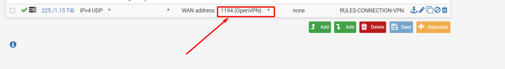

          A perimeter firewall on the server's network is filtering out incoming OpenVPN packets (by default OpenVPN uses UDP or TCP port number 1194).
          there is a VPN rule on the firewall PFSENSE ( internet-> wan ->port1194 UDP)

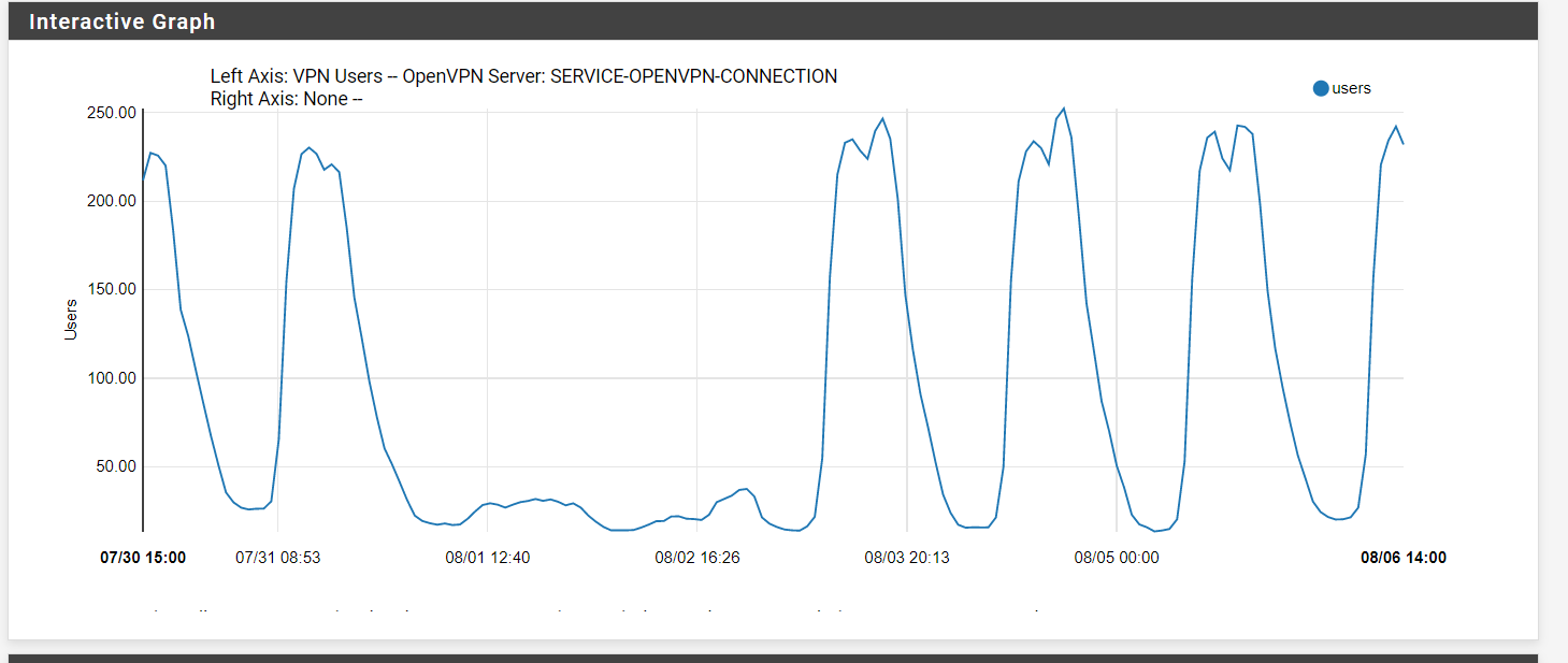

          the connection from users is ok after X minutes or days inclusive.
          sometimes the problem occurs. now i have 283 users connected.

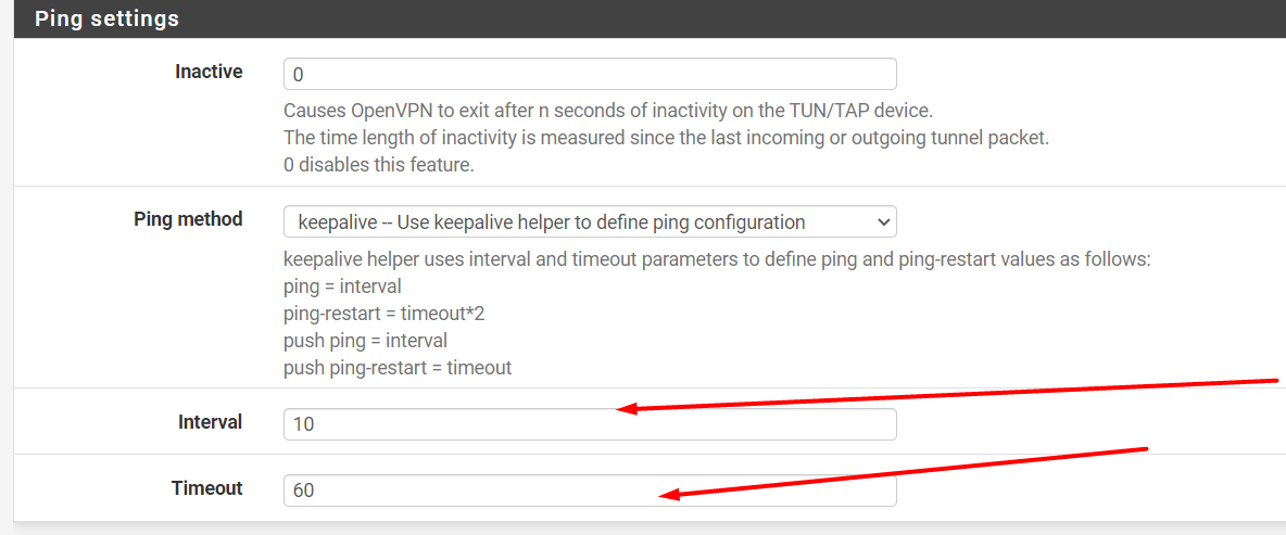

          the clock in pfsense use NTP protocolo, the users too.
          maybe i must change this option a 10 - 180.
            I have several questions when I look at this number:

            @jalvarez-s "maybe i must change this option a 10 - 180."
            worth a try 😉

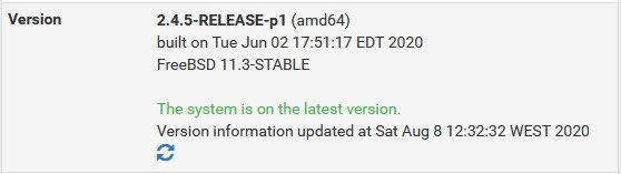

            are you running version 2.4.5-p1?
            is this correct?

              i use version
              thanks you for your help!

                @jalvarez-s "i use version"
                Current version and 2.4.5-p1 contains very important fixes !!! (pfctl, etc.)
                Please Update...... ASAP

                  i´ll update the version this week.
