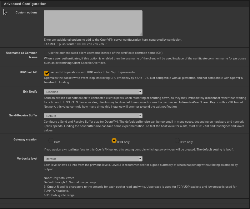

      Hi everyone!
      I have the next specs:
      • FW: Super Micro XG-1537
      • Fiber: 600Mbps symmetric
      • VPN: OpenVPN
      I'm the only connected to the VPN and the maximum throughput I get is 30Mbps when testing it via Iperf. No one else is using the fiber line.
      The client fiber is 300Mbps which I'm connected.
      These are my current settings:
      cryptographic settings.png tunnel settings.png client settings.png ping settings.png advance client settings.png ![advance configuration.png]Very (/assets/uploads/files/1596797729924-advance-configuration.png) general information.png Cryptographic & Thermal Hardware.png
      I've tried different Encryption Algorithm, buffer sizes, UPD fast IO, both transport protocols (TCP/UDP), enabled cryptographic hardware.
      I'm quite desperate so any help would be greatly appreciated.
      Thank you so much for your help in advance!
