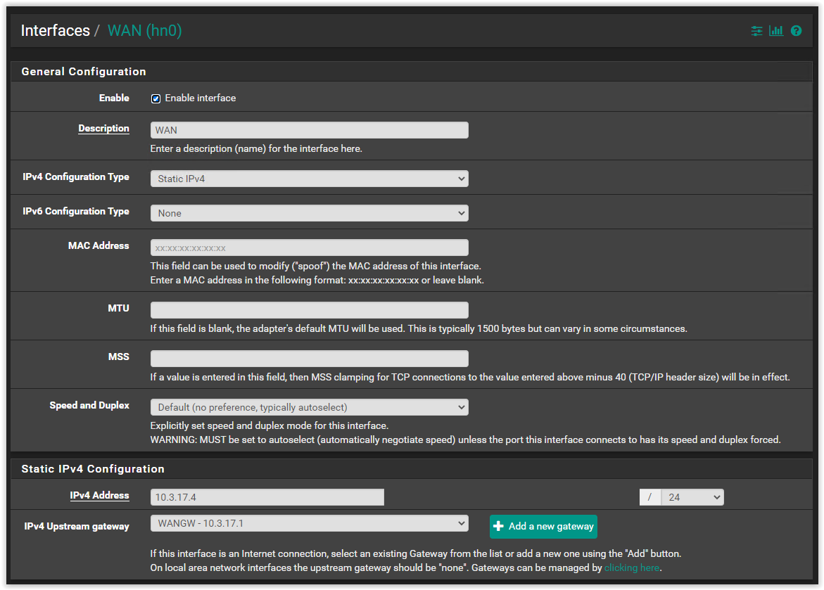

      I set up a virtual network in Hyper-V. My Hyper-V machine has ip 10.3.17.27.
      The thing is, when I installed pfsense I made a wrong installation and allowed dhcp ip for my wan (who is normally 10.3.17.27) so i am having an IP where i configured piratically everything and it works. And sometime it doesn't.
      When I say it works, I mean, I have a website on my dmz and installed it from the ip 10.3.17.4:80 and all my redirections are to this ip. But sometimes the IP 10.3.17.4 doesn't respond anymore and cant do anything anymore.

        You can't use the same IP the hypervisor is using but you should use a fixed IP if you're port forwarding from that to the server.
        Where is that dhcp lease coming from? Hyper-V?
        Either make that a static dhcp mapping so pfSense always gets the same IP on it's WAN from the server or set the WAN interface IP statically in pfSense.

                No, you have to use DHCP if that's how the subnet is configured.
                If you set it static like that it will break when something else is assigned that IP by the DHCP server.

                          Sorry for the late reply. I talked with an ICT guy in my native language. and he explained to me that it could not work properly.
                          I received my Hyper-V IP from the network admin and I should work only on that IP. I didn't notice that i could not use other IP's in this range.
                          Actually it was working so I didn't realize my config was wrong.
                          The DNS 172.20 is not under my control and don' event know where it is😞 . I just received a machine with Hyper-V installed on it and 1 NIC (see below) 18e6af8a-5f0e-467d-8b49-adcd1ec56f6d-image.png
                          With that I had to build on a virtual network. And as I said, I only received IP 10.3.17.27. Buy when I installed Pfsense received IP 10.3.17.4 in my configuration. It was working so I didn't notice that IP was not attributed to me.
                          I don't know if there is any solution to use IP 10.3.17.4 and redirect all the trafic to 10.3.17.27 like using 10.3.17.27 as gateway or something like that ?

                            If you can't get an additional IP to use you have few choices:
                            NAT that traffic in Hyper-V so the pfSense WAN is using some other subnet.
                            Assign the interface directly to the pfSense WAN so it uses 10.3.17.27 dircetly and Hyper-V does not have an IP in that subnet (or uses dhcp)
                            Leave the pfSense WAN as DHCP and find some other way of addressing it so you can access it on that. You never said if the upstream DNS servers can resolve local hostnames.
                            F 1 Reply Last reply Reply Quote 1

                              @stephenw10 I can't get an additional IP. I am trying to find out how to NAT my trafic in Hyper-V with the WAN interface but i'm not sure about how it works so i'm still reading som tutorials and forums. But I think this is what i am going to do.
                              I cannot assing the interface to my pfsense. I think there is a MAC filter who not allows me to send the trafic. I tried once, and lost my connectivity with the machine. the IT admins had to put my initial configuration back.
                              Should it work if I add a new vNIC with a fix ip and route all the network from the new vNIC to my WAN and using my vNIC as pfsense "WAN"

                                Yeah hyper-V can for sure nat.. So pfsense wan would be behind that nat as well as any other nats upstream.
                                If your saying there is a mac address filter, you could always have pfsense wan use that mac.. And don't put an address on that hyper-v interface.
