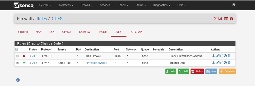

    • I
      Inxsible
      From what I understand pfSense has a default deny applied to incoming traffic on a network. I saw a video where the user put in these 2 rules
      My question is that if pfSense denies by default, why do we specifically need the Block Firewall Web Access rule to be defined? Wouldn't it be denied by default? What am I missing?
      JKnottJ Bob.DigB 2 Replies Last reply
      Reply Quote 0
      • GertjanG
        Gertjan
        GUEST users should be able to connect to the pfSense IP of the GUEST interface.
        Like DNS on port 53, TCP and UDP, and may NTP be port 123, UDP.
        Upfront, port 10443, TCP is blocked, as this is (probably) the GUI interface - and guests shouldn't admin your pfSense.
        This is what I use on my 'guest' network :
        pfSense has no FTP service but ports 22 and 23 could be served.
        Netbios ports (not served) are also 'grounded'.
        I just realized that a rule before the rule showe above :
        already blocks all pfSense ports, except the DNS allowed above.
        The image you showed : the answer depends on what the alias "PrivateNetworks" is.
        Probably all -other ? - local networks like 192.168.x.0/24 so this rules allows guest to visit the net.
        If "PrivateNetworks" doesn't include the GUEST network then the first rule makes sense.
        If it includes the GUEST network, then users couldn't use pfSense's DNS facilities (probably ok for pure DoH fans).
        I 1 Reply Last reply
        Reply Quote 1

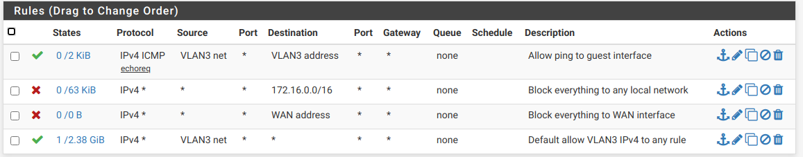

        • JKnottJ
          JKnott @Inxsible
          @Inxsible
          The 2nd line allows guests to do anything, anywhere, which would include the firewall. I did a bit more than that. I allow ping only to the guest network, then block everything else on my home network and also my WAN interface, before allowing access to the rest of the world.

          • Bob.DigB
            Bob.Dig LAYER 8 @Inxsible
            @Inxsible said in understanding firewall rules:
            What am I missing?
            Good question.
            I don't know but it could be the case, that "this firewall" is not blocked by default, because it is on the same network. As far as I know, you can't block any host on the same network other then the firewall itself and that might not be the default in pfSense, so you have to do it manually.
            JKnottJ 1 Reply Last reply
            Reply Quote 0
            • JKnottJ
              JKnott @Bob.Dig
              @Bob-Dig
              On my firewall, I had to specifically allow ping to the guest interface. Without that I couldn't ping it. Of course, as you mention, that doesn't stop guests from seeing others, unless blocked by the AP.

              • johnpozJ
                Well his rule below that allows anything that is not rfc1918, or that is what I am guessing from his privatenetworks alias.. Maybe he has multiple Ips on the firewall that are not rfc1918?
                Say his wan.. If he only had the one, would prob be better/clearer to use wan address vs the every IP on the firewall alias?
                Where did you see that? Also keep in mind many users post up guides and images of how they do stuff without really understand what they are doing ;)
                1 Reply Last reply
                Reply Quote 1
                • Bob.DigB
                  Bob.Dig LAYER 8
                  So I tested it myself and I was wrong. But I thought having seen it this way often. ๐Ÿ˜Œ
                  So the first rule is not needed if the alias contains all rfc1918, which it looks like.
                  JKnottJ 2 Replies Last reply
                  Reply Quote 1
                  • johnpozJ
                    Also pfsense out of the box wouldn't even be listening on port 10443, guessing he is using that as his webui port? Would be my guess.
                    edit: d'oh he even calls out block web access ;) Unless he has multiple IPs on his firewall that do not fall within his private alias, no reason to use the this firewall alias. Then again it is a way to make sure you block access to any IP the firewall might have.
                    1 Reply Last reply
                    Reply Quote 1

                      • JKnottJ
                        JKnott @Bob.Dig
                        @Bob-Dig
                        In my rules I used 172.16.0.0 /16 to block the entire range. I could have done that, but didn't see RFC1918 in the available selection.
                        UniFi AC-Lite access point

                                • JKnottJ
                                  JKnott @johnpoz
                                  @johnpoz
                                  I have created the alias and see I can add it to rules. However, I'm surprised it wasn't already there, given it's a default rule on the WAN interface. However, adding 172.16.0.0 /16 was easy enough.

                                  • I
                                    Inxsible @Gertjan
                                    Thank you all for your responses. Let me answer any questions that were directed to me.
                                    @Gertjan said in understanding firewall rules:
                                    Yes the PrivateNetworks did not include GUEST & IOTCRAP. It included all the other networks that are listed on top -- ie LAN, OFFICE, CAMERA & PHONE
                                    @JKnott Thanks for your rules. They make sense. Was the Allow ICMP rule only to make sure that you can connect to the GUEST network in case the internet is not working for the Guest device?
                                    @johnpoz said in understanding firewall rules:
                                    No privatenetworks were just his other networks as I mentioned above. I don't think he included the RFC1918 networks. If we include RFC1918 -- would it mean that 2 guest devices won't be able to see each other either?
                                    This was a youtube video by Lawrence Systems. Here's the link: https://www.youtube.com/watch?v=ouARr-4chJ8
                                    So from all the replies, I understand that if you include the RFC1918 networks, then you don't need to explicitly create the Block rule for the Web Admin to pfSense. But if the RFC1918 is not included in the alias, then that rule is required in order to explicitly block Guest devices from accessing the pfSense admin.
                                    Thank you all again -- you guys gave me some good tips regarding firewall rules. Much appreciated.
                                    Reply Quote 0

                                      • JKnottJ
                                        JKnott @Inxsible
                                        That is correct. I like to be able to test things. With my rules it is possible to ping elsewhere on the Internet, but if that fails, where's the problem? With pinging the interface available, I know at least WiFi is working properly and pfSense is up.

                                        • johnpozJ
                                          So that have that same rule on all of their interfaces they were showing.. But if they are only going to have allow rules to specific - like the camera vlan where he only allows access to camera server on 192.168.5.5 it serves no real purpose..
                                          Reply Quote 0
                                          • I
                                            Inxsible @johnpoz
                                            So I guess the reason they didn't block the RFC1918 address is so that they could allow the CAMERA net to have access to their NVR which was on their internal LAN.
