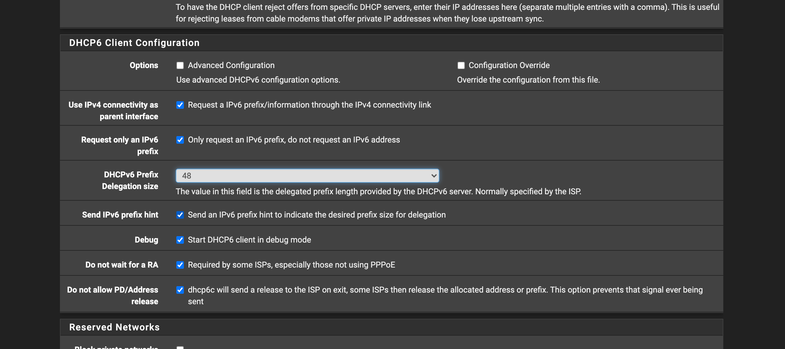

                      My tips for figuring out your IPv6 setup.
                      1. Figure out how much is delegated to you by your ISP in my case a /48 (LAB) (ignore the other checked boxes as that only applies to my system)
                        Screen Shot 2021-03-24 at 4.41.37 PM.png make sure "start DHCP client in debug mode" is checked

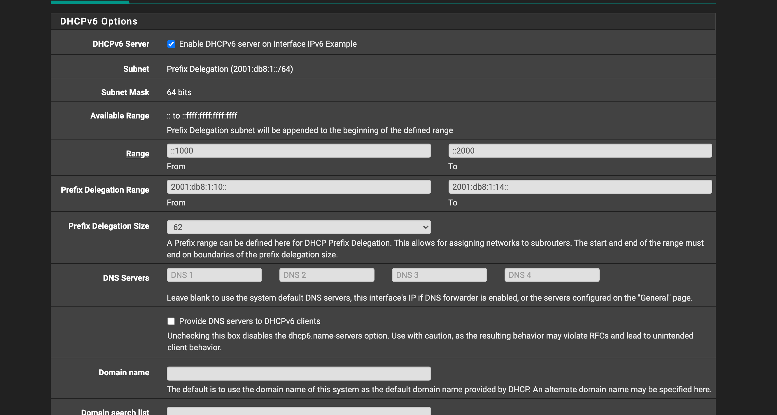

                      4. Divide it into something bigger than /64 as a /64 only allows for one subnet, if that applies to you (if you want more that one IPv6 network behind the USG
                        than spin up a dhcpv6 server with two of those addresses in the "Prefix Delegation Range" section

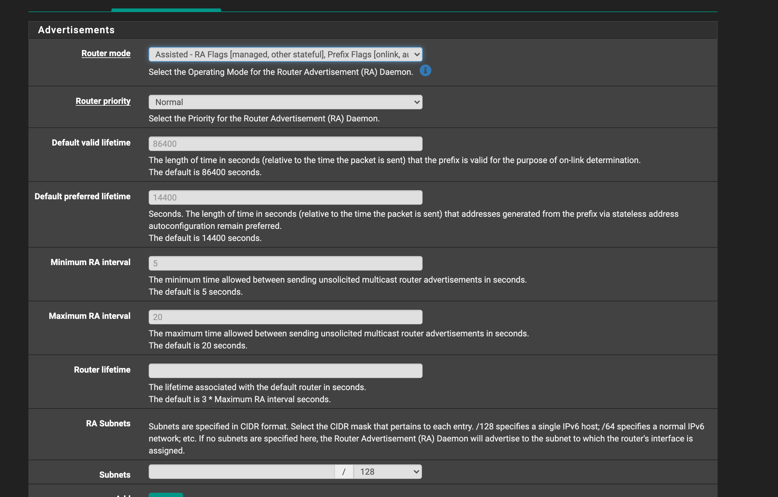

                      7. make sure your router mode is properly set!

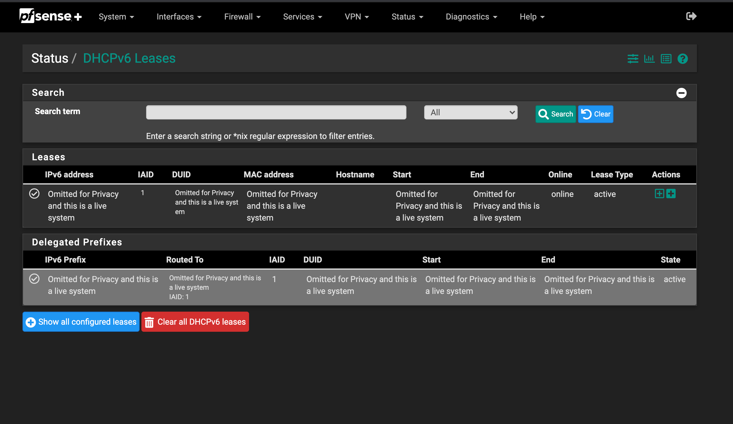

                      8. leases should show up here:
