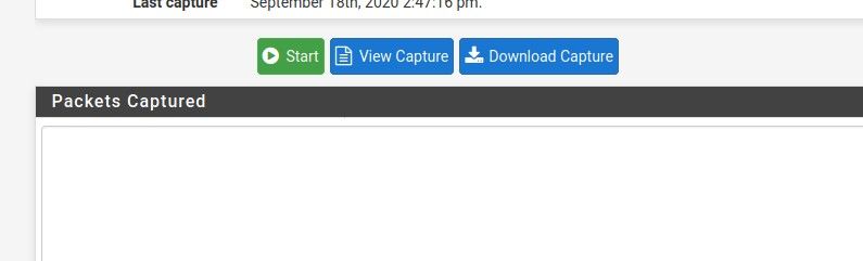

                  In GUI (Diagnostics -> Packet Capture) if i capture with filter : 10.13.0.20 , 8.8.8.8 . No output:
                  Selección_105.jpg image url)
                  But in Cli : tcpdump -ni em0 host 10.13.0.20 get output
                  But independently of this, and this what i don't understand : **the packet 10.13.0.20 -> 8.8.8.8 : icmp no should match with the "deny" default rule ??? (at least) or "pass" if it match with another rule **
                  Thanks

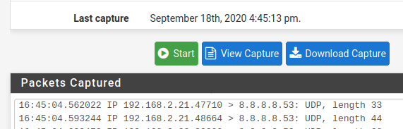

                      yes, capture something similar, for example :
                      Thanks

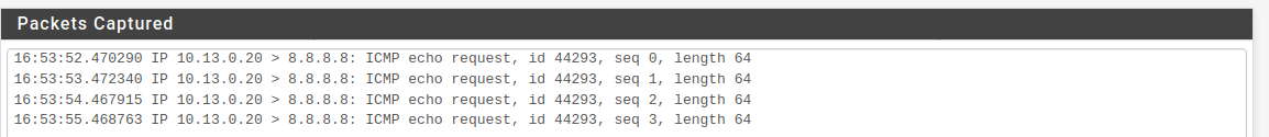

                        @johnpoz,i realize that in gui put the wrong interface:
                        Now i see on GUI, but still no show "deny" or "pass" traffic on /var/log/filter.log
                        Thanks

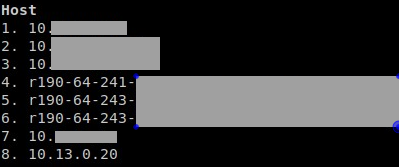

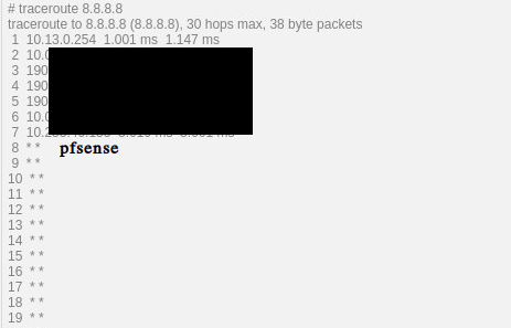

                                Is this 10.13.0/24 network downstream network? Yes , there are hops to an MPLS, no directly attached, no NAT used by us (asking to ISP ), and pfsense cant reach to it.
                                From 10.13.0.20 -> to 8.8.8.8
                                I take it the actual problem is this 10.13.0.20 is trying to ping 8.8.8.8 and you get no answer?
                                10.13.0.20 no reach 8.8.8.8 because its cut in pfsense
