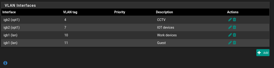

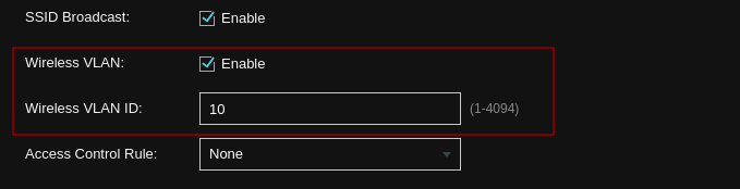

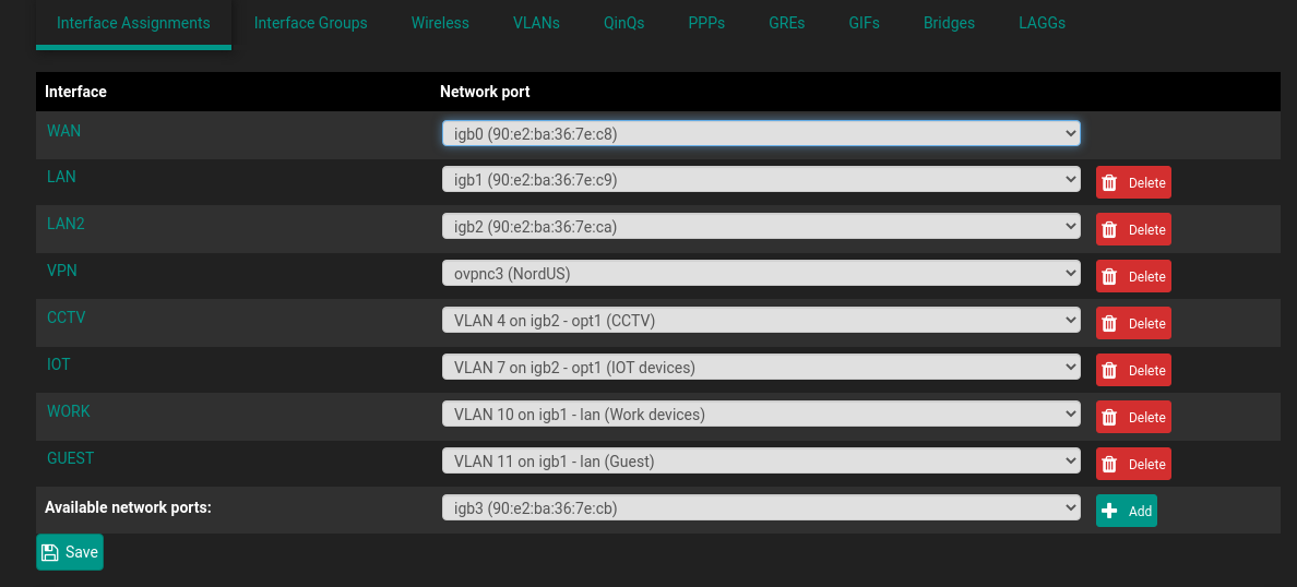

    Unable to connect to wireless SSID with VLAN

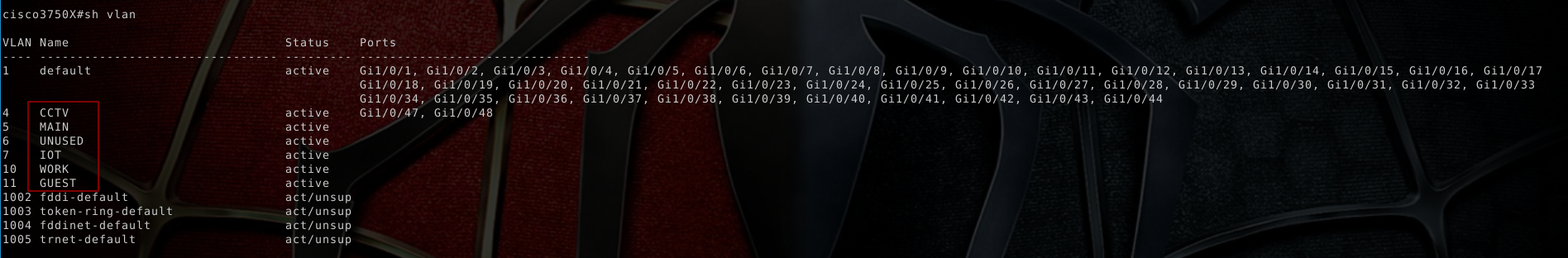

          You need more Port config.
          int gi1/0/4
          switchport trunk encapsulation dot1q
          switchport mode trunk
          switchport trunk allowed vlans add 4,7,5,10,11
          switchport nonegotiate
          exit
          check it with "show run int gi1/0/4"
