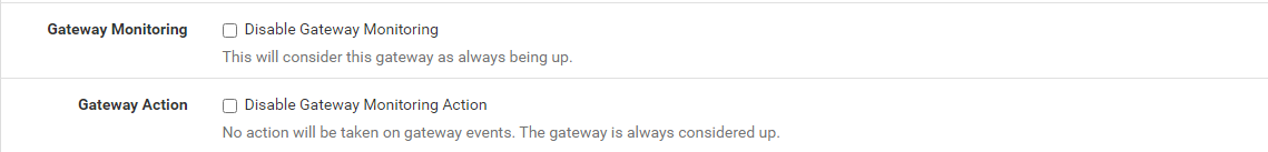

      I use FW rules with specified GW for routing traffic over VPN. Recently, I setup a VPN where I can't get GW-monitoring working because the far end does not allow any ICMP. I thought I would just disable GW-mon and therefor it would be "Always Online". However, now the FW rules are just ignored. There are 0 evaluations even though it is high up on the order. My PC still hits the default at the bottom. I have tried rules with all * and still no dice.
      I do have the "Skip rules when gateway is down" option selected in System/Advanced/Misc because I need this type of behavior.

        You have the top option check and not the bottom one? If so, try it the other way around and see if that works. Monitoring graphs I suspect will still show no response, but it will be ignored. Maybe a workaround of sorts.

          I have tried selecting both options and individually. I even tried setting the monitor IP to 127.0.0.1 to try to fool it. In each case, I see 0 for all stats on the FW rule. (eval/packets/bytes)

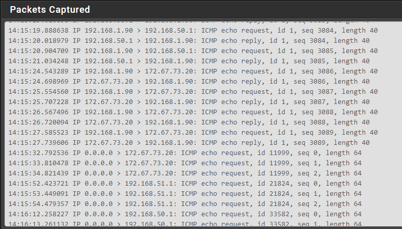

          On a side note, I have one specific VTI where I control the other side's Edgerouter and therefor allowed all traffic. From my PC, I can ping and access the router and internet across the tunnel. However, when pfS pings, it uses source 0.0.0.0 IP and fails the ping. Hence monitoring isn't working either. But, fixing this only fixes one of my tunnels at home since I'm not allowed to ICMP to the vendor at work.

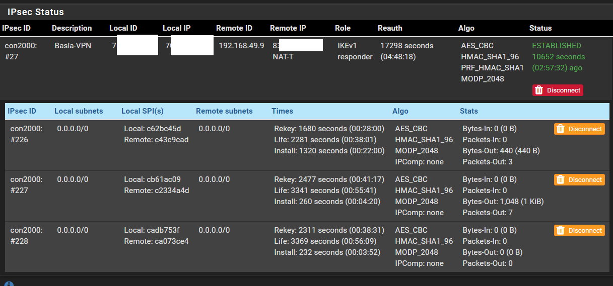

            @jimp Can you weigh in on this? I saw your reply to me on the other post. I agree that the P2 negotiation is expected behavior and not related to the OP in the other thread.
            In my case, I think it is relevant because from my understanding, pfS uses the Local subnet from P2 as it's VTI address. Hence it uses 0.0.0.0 as the source IP for pinging across the VTI.

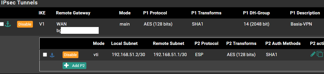

                Ok, so how does pfS choose the IP from which it will ping across the VPN? I setup the connection using the standard VTI guide.
                My issues are pretty clear:
                1. pfS uses 0.0.0.0 as source IP and Ping fails
                2. Ping failing means GW-mon doesn't work which means I can't use FW rules specifying that GW.

                      FIXED. The issue was with the remote subnet. I set it to address instead of /30 network after stumbling on your Routed-IPsec slides from 2018 hangout.
                      With GW monitoring working, my FW rules with specified GW instantly started working. Can you confirm that these rules get ignored even when GW-mon is manually disabled?
