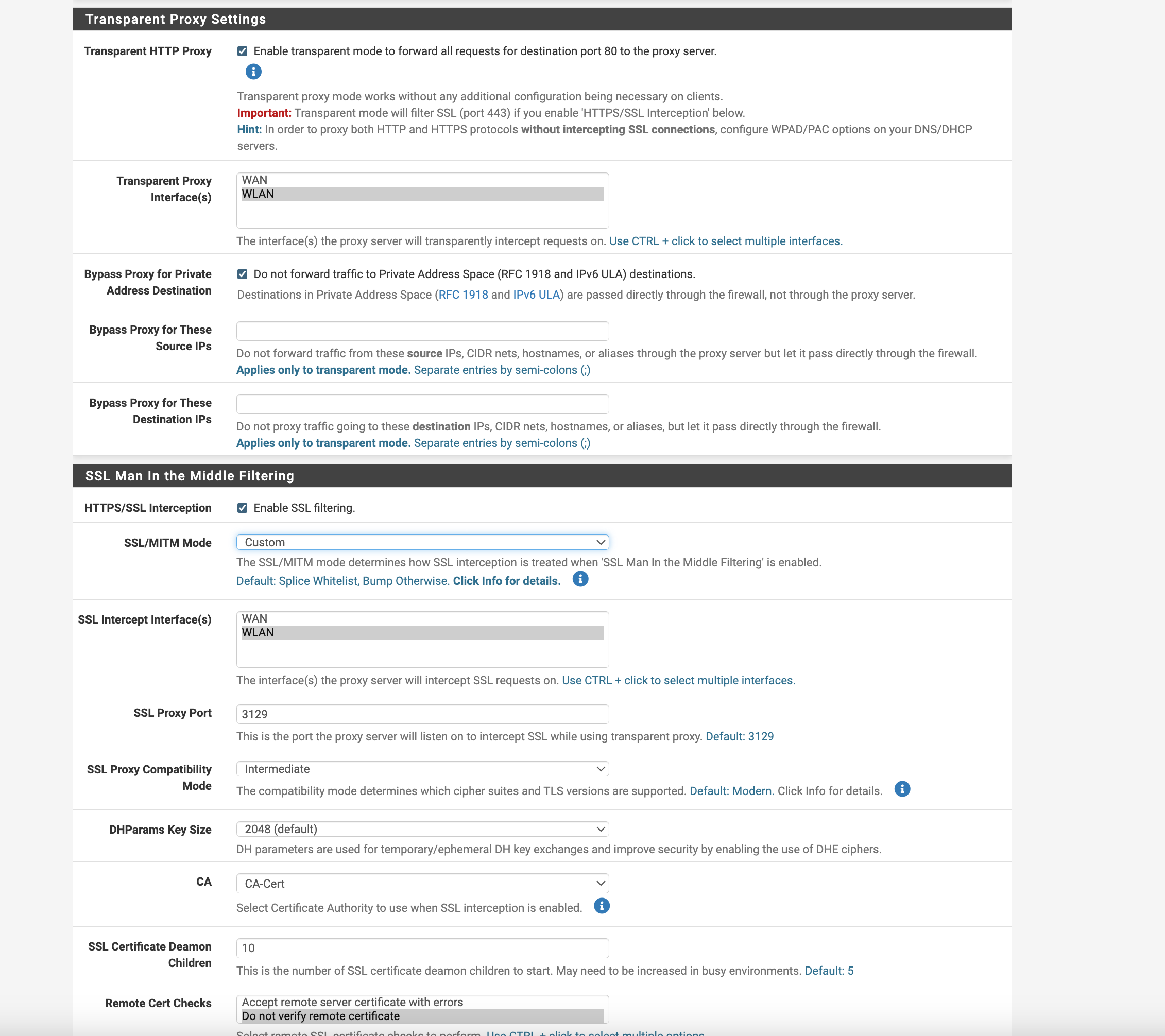

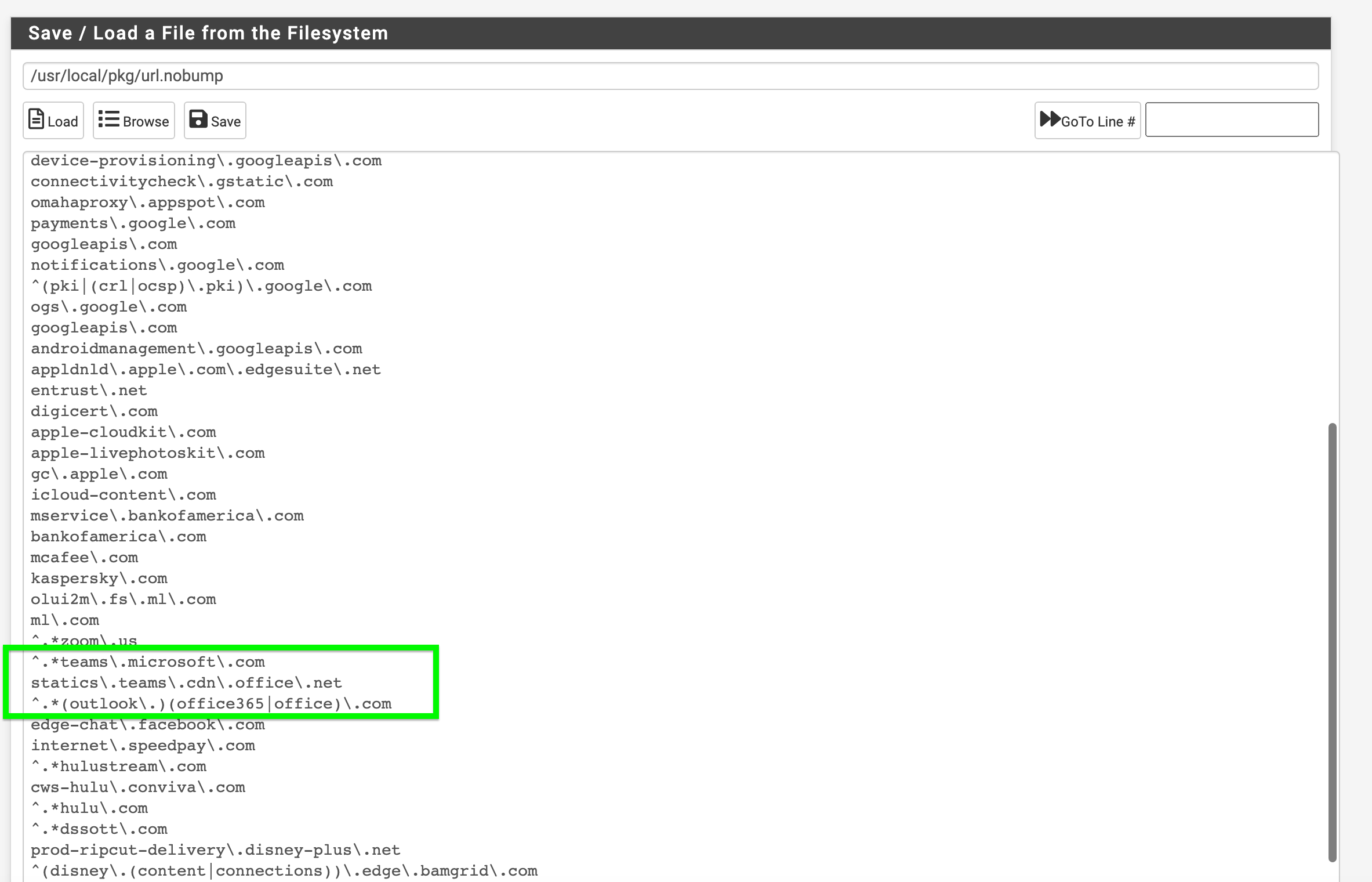

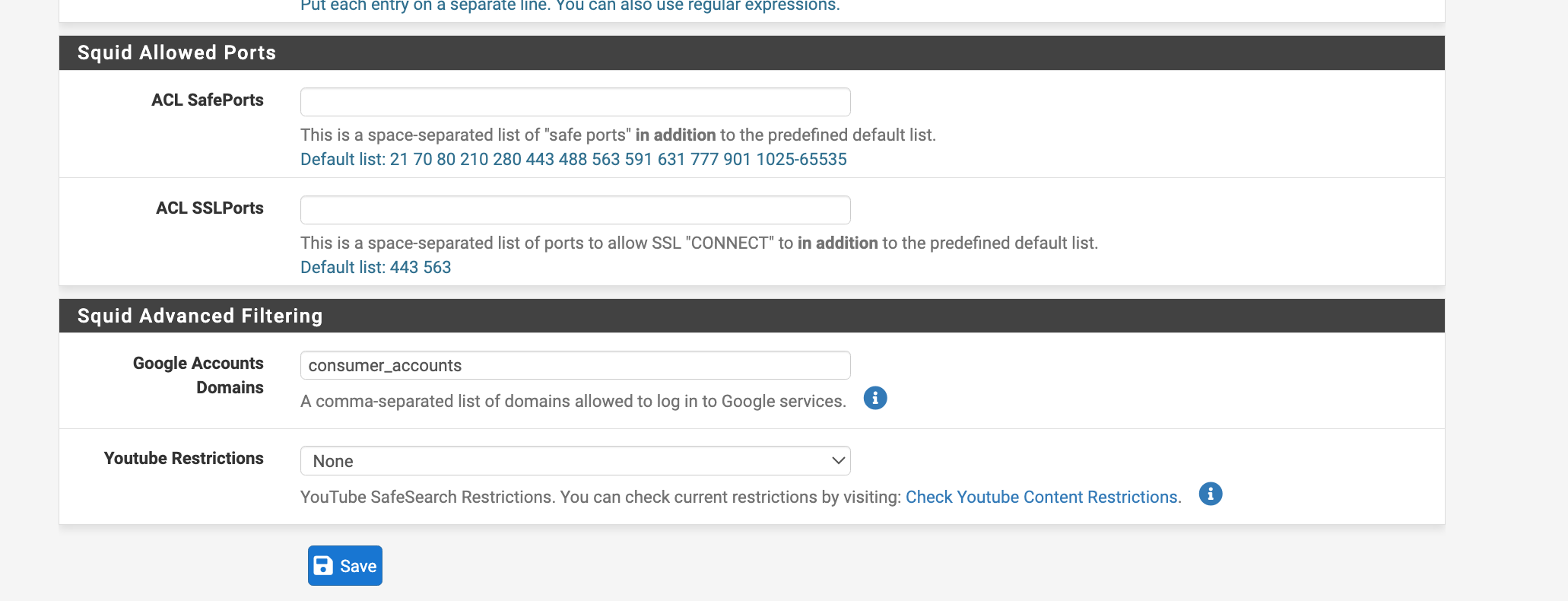

                      @sultanofswing sultanofswing what ports are needed for that application? You may need to add that as an approved port for Squid too not just the ACL lists.
                      (Custom)
                      Have you tried custom and setting the snapchat to splice only?
                      (SSL Intercept set to custom)
                      (Example with regex expression with office set to splice only)
                      I personally would set snapchat to splice and leave it alone.
