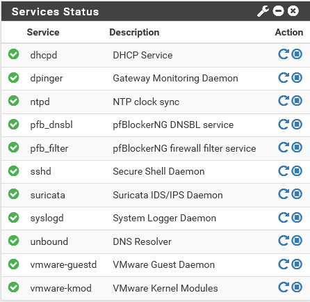

        • Cool_CoronaC Offline
          Cool_Corona
          Nope. No service watchdog installed.
