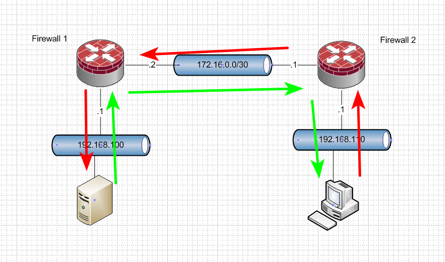

                        That is fine - that is not the problem... The problem is your host is in the transit network... So unless you create a route on it that says how to get to the 110 network, its always going to be asymmetrical.. Because he will just send traffic to his gateway..
                        See the arrows.. Do they follow the same path? Red is start of convesation, green is answer.
                        You should not place hosts on a transit network.. A network that connects routers together.. Or your going to end up with asymmetrical traffic.
                        If you have host(s) in this 192.168.100 network - then use something else for transit 172.16.0/30 for example... Or move this host to another network.

                            Something like this would be a better setup.
                            Now you do not need to do any host routing on devices, and you don't have to worry about nat between these rfc1918 networks. And your flow is always symmetrical

                              i will move my client to an separate network, like your picture. i think thats the best way. thank you for the example.
                                Just keep in mind that if a network connects 2 or more routers together.. You don't put hosts on that network or any traffic to and from that host will be asymmetrical.. Unless you specifically tell the host which router to use to get to which network.. Or you nat so that the host on the transit only ever sees IPs from its own network.
