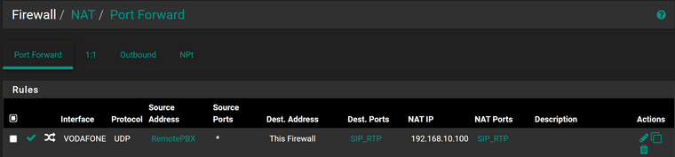

                                        • W Offline
                                          wintok @MAW
                                          @maw I've configured port forward and I tested it to make calls but still no audio, not sure if this is the correct port-forwarding. To be honest I have not seen this type of port-forward. I've still alot to learn ..
                                          Appreciate your help
                                          M 4 Replies Last reply Reply Quote 0

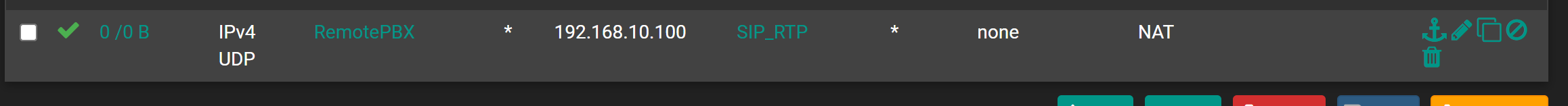

                                            MAW @wintok
                                            @wintok Hmm, not sure that looks right.
                                            There is usually two parts to a port forward in pfSense
                                            Please read here on how to add a Port Forward in pfSense.
                                            https://docs.netgate.com/pfsense/en/latest/nat/port-forwards.html
                                            Scroll down to the section "Adding Port Forwards"
                                            In pfSense you add a port forward in Firewall --> NAT --> Port Forward
                                            Once you add the port forward definition and save it, a firewall rule on the relevant interface will be auotmatically implemented using the port forward definition you just created.
                                            So when you are finished,you should have......
                                            a) A port forward definition under Firewall --> NAT --> Port Forward.
                                            b) A Firewall rule on the WAN interface that employs the port forward definition you created.
                                            Do you currently have that?
