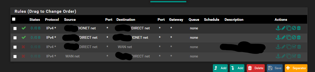

            I blocked out the names, for security reasons.
            So IONET is my primary net 10.10.10.xx (vlan here is 1-default)
            DirectNET is the net at 192.168.0.xxx (vlan here is also 1, but im bypassing the vlan mismatch by using the extra NIC onboard my pfSense install) I want to access from 10.10.10.xx
            In addition, blocking WAN to DirectNet, and vice versa
            Now, same firewall rule on my 10.250.250.xxx adapter to IOnet allows perfect routing to and from its associated vlan, on VLAN_NET adapter, specifically laid out for 802.1Q trunking. Pings to hosts on that lan are good.
            Sorry if I repeated myself, just trying to get the info out there, because I am stumped, or maybe its the back to back double shifts getting to me.
              And which interface are these rules on ionet or direct? Can tell you for sure right now that both of those rules are not needed. Only 1 of those are needed.. What interface are these rules on?
              That would be the source net.. And the dest would be the other network.
              How and the F would wan net ever be source as traffic into this enterface - be it io or direct?

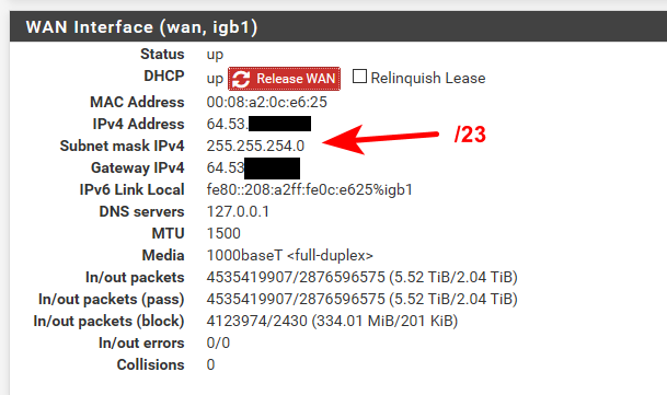

              You understand also that wan net, is just that the network attached to the wan - it does not = internet... It equals the network the wan is connected to via its mask.. For example mine is
              How could your wan net ever be a source into the interface your showing which is either ionet or direct? 10.10.10 or 192.168.0??
              On the network that wants to create traffic to the other net.. Create a rule that allows that net to the dest net. Done! That is all that is needed to be done.
              If it is not working.. Then look to your dest device - is it running a firewall, does it point to pfsense as its gateway?
              I show no hits on any of these rules at all.. Where did you put them?? On which interface?
