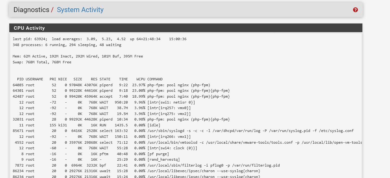

                @kiokoman said in php-fpm: pool nginx (php-fpm) eats all CPU:
                screenshot of diagnostic / system activity
                • kiokomanK Offline
                  kiokoman LAYER 8
                  you can install lsof with
                  pkg install lsof
                  the process consuming wcpu is PID 64085 and 64301
                  check that
                  are you using ipv6 with ipsec ? dual stack? ikev2 ?

                                • kiokomanK Offline
                                  kiokoman LAYER 8
                                  it is checking for an expired account and after that I see haproxy stats
                                  maybe try to temporarily disable haproxy stats

                                        nothing useful inside Status / System Logs / IPsec ?
                                        hopefully, someone will chime in on this I have no idea, I don't use that many IPsec but I don't think that only 25 IPsec is a problem
                                        maybe that "no such file" are the culprit
                                        go inside any ipsec and just press "save" and see if they are generated
