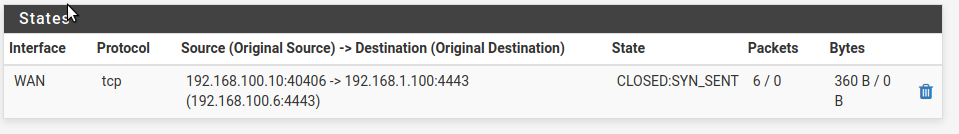

      i dont know much about routing, however I can see that connection is reaching pfsense now and it becomes SYS_SENT / CLOSED

                            from .10 i cant connect to 192.168.100.6:4444 (i can see packages arriving in PFSense with CLOSED:SYN_SENT)
                              Well if devices on your network behind pfsense have firewall.. Pfsense can send the traffic to this IP all day long - doesn't mean that box will answer..
                              Here is the thing - sniff on pfsense lan interface in pfsense. Do you see it send the traffic on that you port forward? If so then pfsense did what its suppose to do.. If you get not answer that is nothing pfsense can do about that.

                                          When Promox communicate with 192.168.100.6 (pfsense) the packages seems to be arriving at PFSense, verified by states print above.
