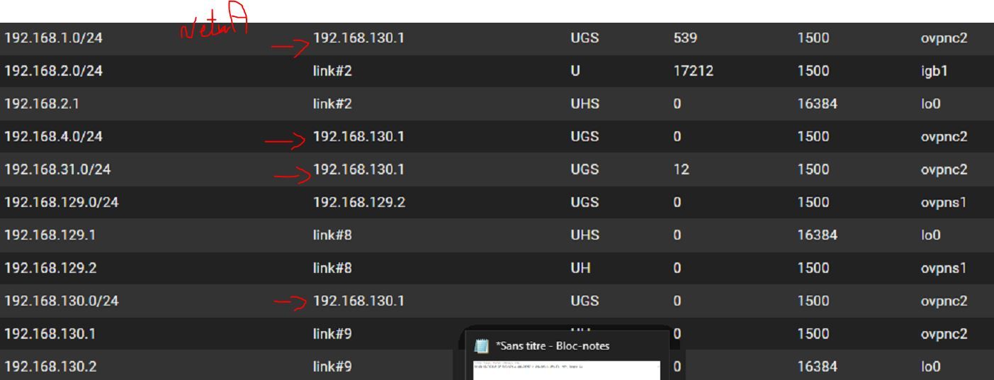

          My site A is on local network 192.168.2.0/24, and Site B network 192.168.31.0. A route is missing on the server, dunno why it is not create itself with setting I've made?!?!?
          I joined a screenshot for the routes on my server. Thanks to help me understand.routes.JPG

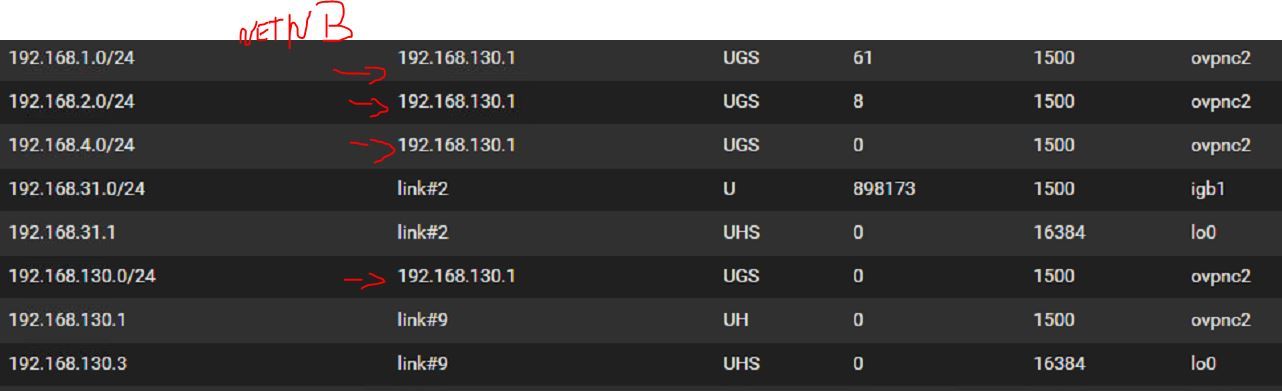

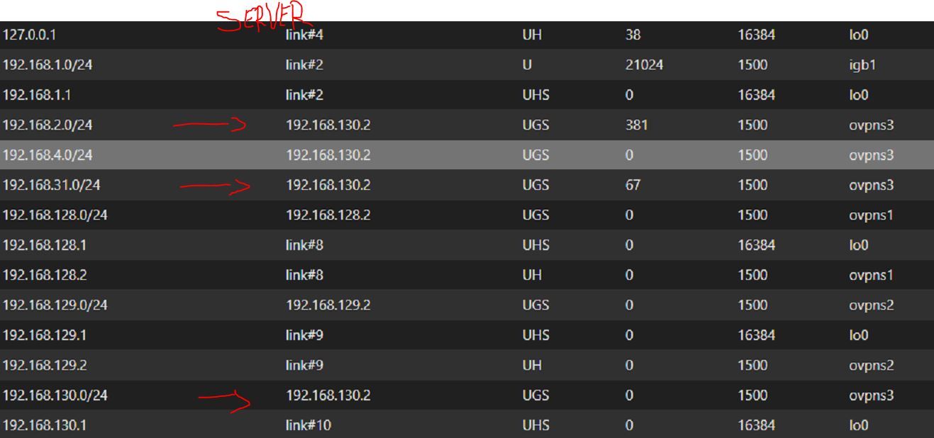

              I joined route's screen shot for my 3 pfsense. On server's side route, it's anormal that gateway for the route to join network B (192.168.31.0) is 192.168.130.2 (same as route to network A 192.168.2.0) ?!?!?!? I think that's my problem but I dont know how to resolve that.
              Thanks for your suggestion or correct me if I'm far from best practice, I want to be sur everything will be ok before put these routers in production!
