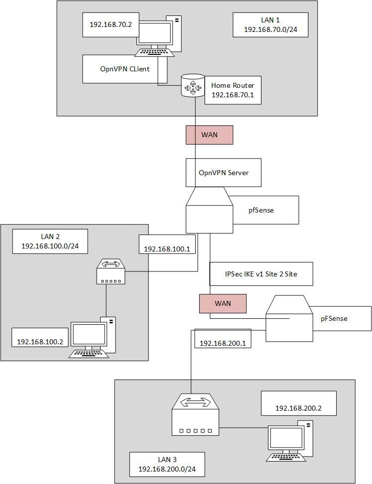

        I would really help if you drew this.. Sounds like from your fist sentence your vpn to some server behind a pfsense? And then this pfsense at site B has a ipsec vpn to a 3rd?
        • T Offline
          TSO2
          Yes Of Course,
          I want to ping ( connect to ) 192.168.200.2 from 192.168.70.2
          I can ping anything on 192.168.100.0/24 from 192.168.70.2
          I can ping anything on 192.168.200.0/24 from 192.168.100.0/24
          but cant see anything 192.168.70.2 -> 192.168.200.0/24

            @TSO2 said in OpenVPN Routing on pfSense:
            I have added the route to ( LAN 3 ) on the ( LAN 1 ) device ( actually the OPNVPN client did that for me )
            You need also a route on the pfSense box in LAN 3 to the OpenVPN clients network.
            This must be done in IPSec. Add an additional phase 2 to the IPSec configuration on LAN3 pfSense with 192.168.200.0/24 as local and and the OpenVPN access servers tunnel network as remote network.
            Also set the additonal phase 2 on the pfSense in LAN 2 with inverted networks.

              • T Offline
                TSO2
                I get that now, I am going to try the routing from the IPSec to the OpenVPN subnet
