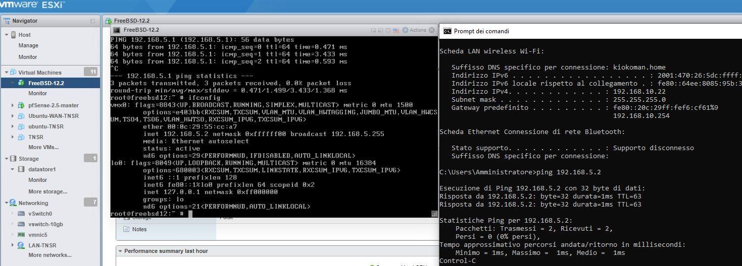

            @JKnott i tested it a moment ago on my test-lab and it work ...

                                I was just proving that it works, I was not debating the fact that it's borked and nonsense, people sometimes want the answer without any questions. I would had suggested a VLAN if the op had told us for what was that configuration need for 🙄
