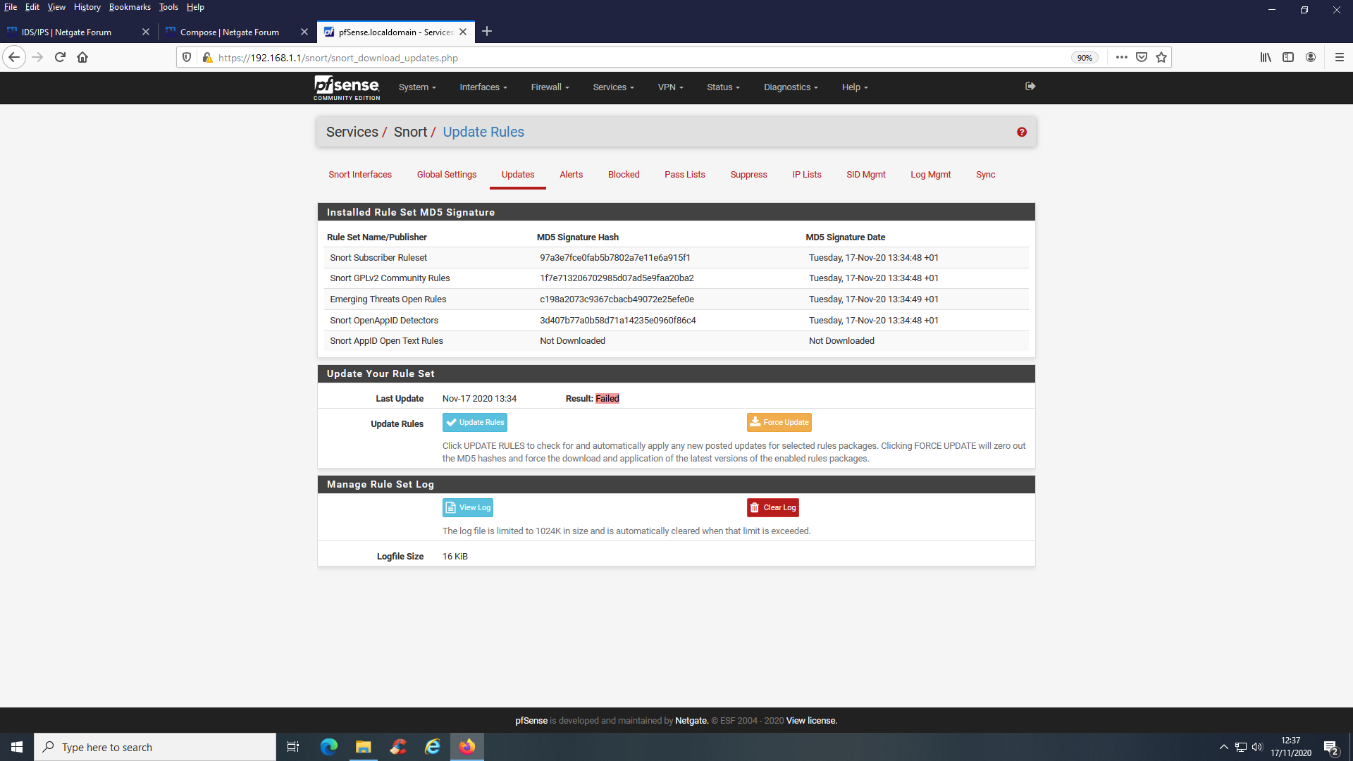

      Anyone else seeing that Snort is not updating today?
      I tried "force update" as well. All my packages are up to date.

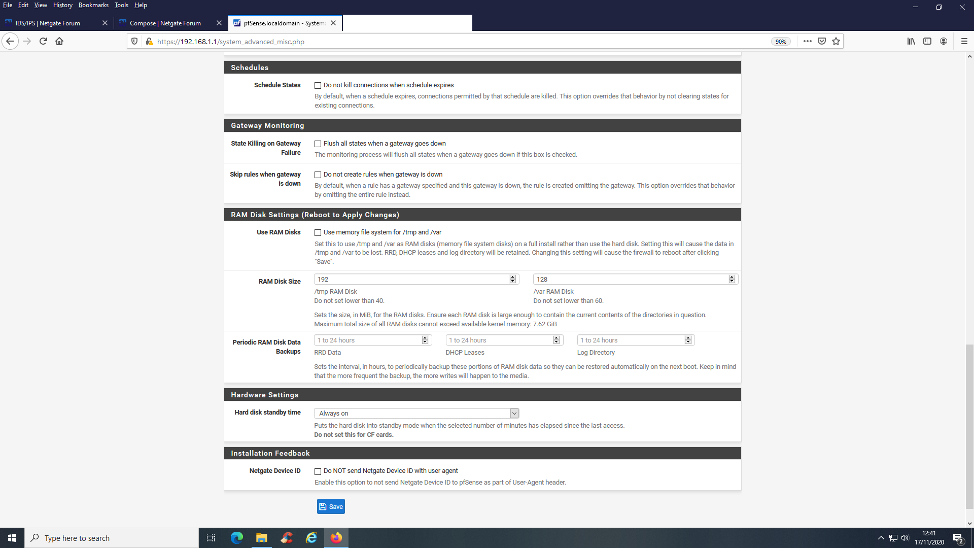

      If I goto
      system advanced -> miscellaneous -> then see
      "RAM Disk Settings (Reboot to Apply Changes)".
      Screen grabs are proof 2.png 1.png of what I am talking about.
      I have 8 GB RAM with a 15-5250U Qotom mini PC as a firewall.

        RAM disks are a VERY bad idea for Snort and Suricata because the disk can run out of space during updates. Snort and Suricata cleanup after themselves when an update completes (whether it succeeds or fails), so when you go and look at the pfSense Dashboard you won't see the RAM disk out of space.
        To see if that is the problem, examine the pfSense system log and look for any errors there about disk space.
        There was also apparently a temporary issue with some of the SSL certs used on some pfSense URLs. If you are using the OpenAppID text rules, that very well could be the problem. That download failed due to the expired SSL cert on the pfSense host where those files reside. You can examine the Update Log on the UPDATES tab to verify. If the SSL cert expiration is your problem, it will resolve itself when the SSL cert is updated on the server. There is nothing you can do from your end.

          Mine didn't update either, it was a cert issue the far end.
          All working fine now.
