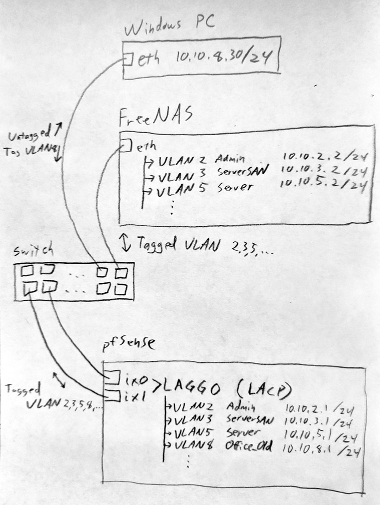

            Below is a diagram that shows my network layout. I didn't diagram it, but there's also a Proxmox server configured similarly to the FreeNAS server. It has IPs of:
            10.10.2.20/24
            10.10.3.20/24
            10.10.5.20/24
            10.10.8.20/24
            • H Offline
              hillisdr
              And with your prodding, I think I just figured out the problem. Both the Proxmox and FreeNAS servers probably shouldn't have vlan8 interfaces if vlan8 traffic is getting to them via vlan5.
              I deleted the 10.10.8.20 and 10.10.8.2 interfaces and I think the problem is fixed.
              Thanks for your help!

                • H Offline
                  hillisdr
                  Yes, all routing should be done at pfSense.
                  I had intended connections from hosts in 10.10.8.0/24 (vlan 8) be routed to servers in 10.10.5.0/24 (vlan 5) or 10.10.2.0/24 (vlan 2) via the pfSense router. But two main servers had interfaces in vlan 8, so I'm assuming return traffic was coming back that way, instead of being routed through vlan 5 or 8 the way they came in.
                  After removing the server interfaces in vlan 8, return traffic must flow back the way it came in, and everything is working again.
