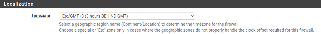

          I noticed that too.
          Changed from America/Sao_Paulo to GMT +3 and it fixed for me.

                            Answering Stephenw10, yes it is showing GMT +2, which means 2 hours behind than GMT. America/Sao_Paulo should be GMT +3, which is 3 hours behind GMT.
                            cesarmsjC 1 Reply Last reply Reply Quote 0

                                I understand, but they calculate like this:
                                GMT + X = LT
                                So, X is added to GMT to reach the desired LT.
                                Can you see the message after Etc/GMT +3 --> (3 hours behind GMT) ?

                                    2.5.0 is coming, maybe it will be fixed by then.
                                    Change to GMT +3 for now, and it will fix it until a patch or a new version is released.
                                    Same behavior on 2.4.5p1

                                      3hrs difference when I set Sao Paulo.
                                      It's unlikely this will be corrected before 2.5 is released. I would just set GMT+3 until then.
                                      cesarmsjC 1 Reply Last reply Reply Quote 1
