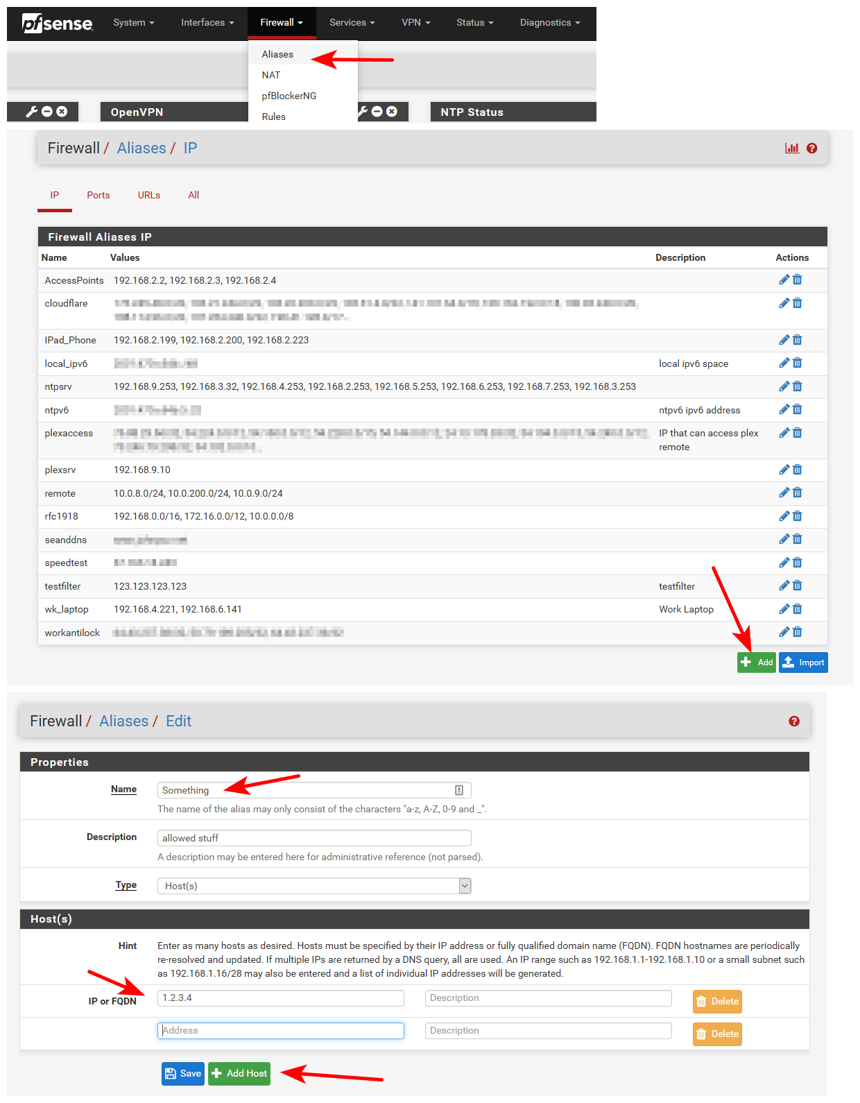

        Just create an alias with the IPs in it. Use that as source on your port forward. There you go only those IPs can access what you forwarded.

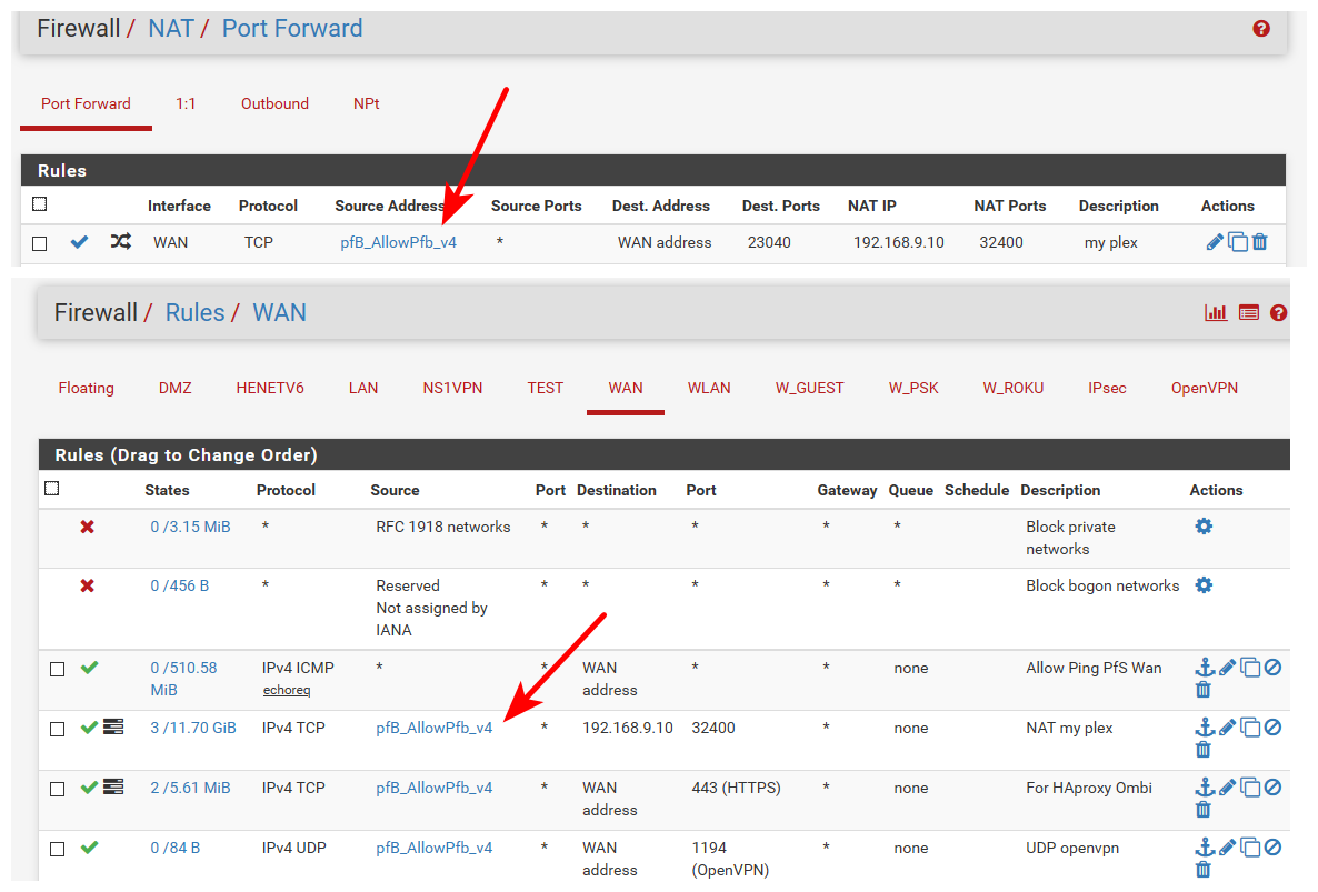

            Under aliases - create one whatever name you want..
            Then use it in your port forward rule.. as the source, when it auto creates your firewall rule it will use the same alias.
