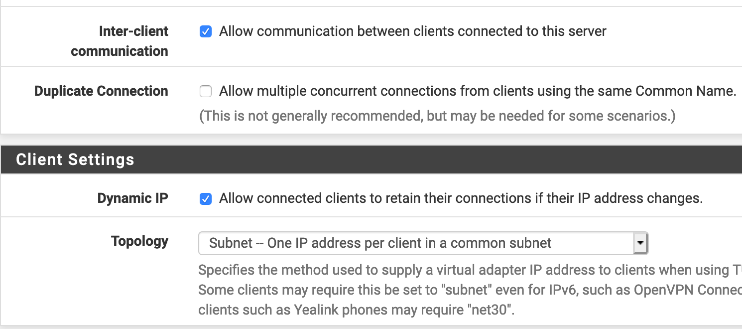

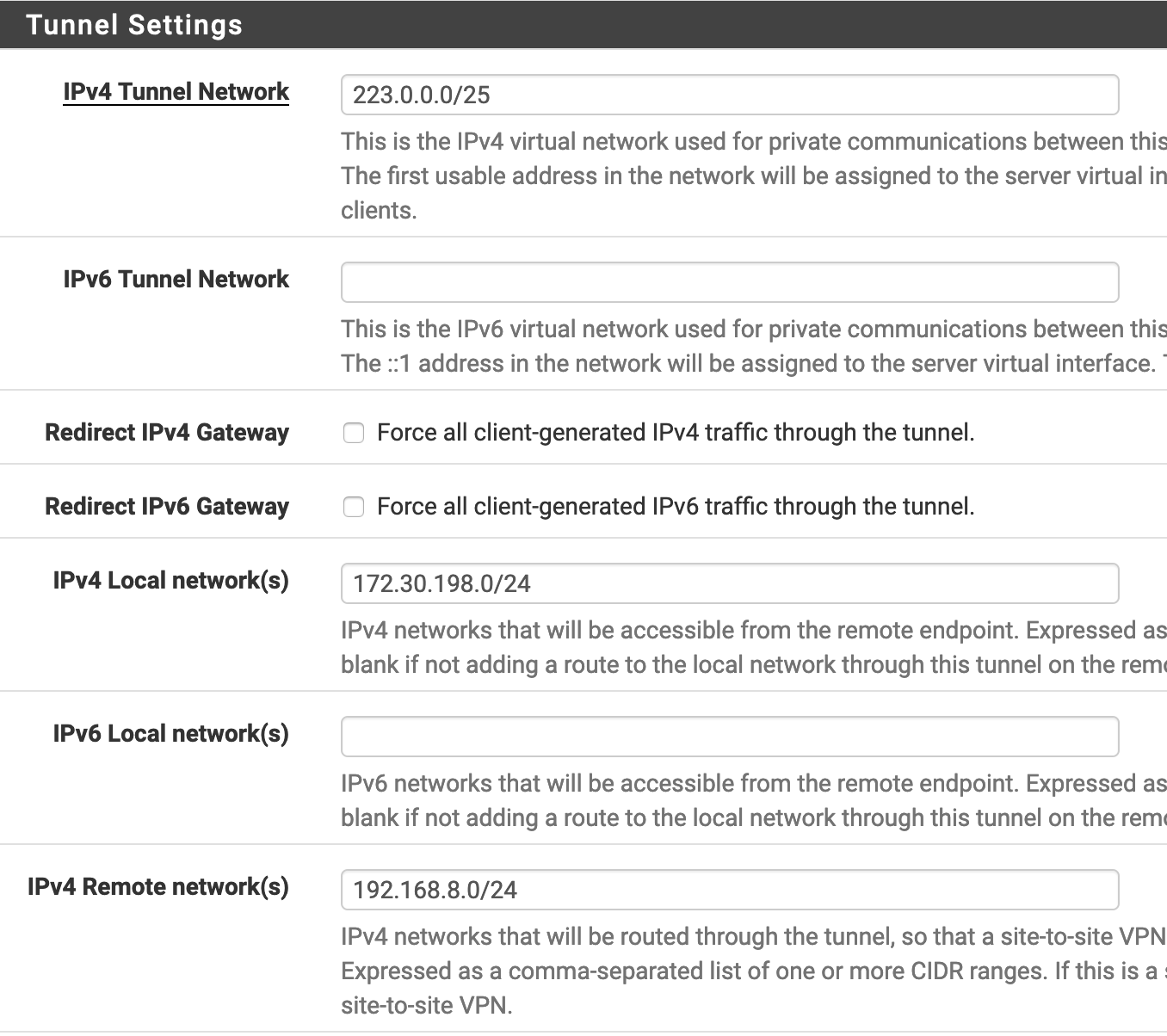

      I configured a OpenVpn server in this way:

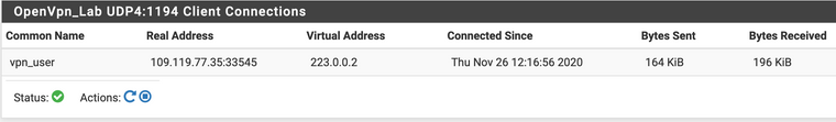

      Exported the configuration, the VPN is up and running,
      but from OPT1 I can't ping or traceroute the remote IPs 192.168.8.0/24, but I can do the reverse thing, from 192.168.8.0 I can ping 172.30.198.0.....

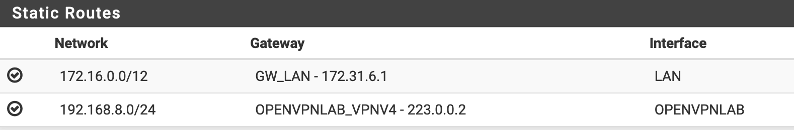

      It seems that the pfsense don't have a route to 192.168.8.0......So I put a static:
      but nothing has changed.....

        Don't use public IP ranges for a VPN tunnel network! Also for a site-2-site a /30 mask will be sufficient.
        Don't use static routes with VPN gateways! The route is set by OpenVPN.

          Why are you using 223.0.0.0 /25? You should be using something from RFC 1918. Also, you don't need a /25, unless you have several clients. If it's just a single client at the other end, a /30 can be used or even /31, though that may cause problems for Windows.

              Yes, though, as I mentioned, it might cause problems with Windows. The original thought behind a /30 was you needed 2 addresses for the end points and 1 each for broadcast and network, but neither of the latter is needed for a point to point link.
