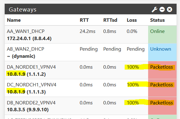

      Hi there, I see those two problems on a regular basis. I know, these are not bad problems, but I would like to see some mitigation from pfSense here.
      Problem one is that after a boot-up of pfSense, those vpn-client-connections are all shown as offline and stay so, but they actually do work, unless...
      problem two comes into play, that some connections get the same IP-address from those vpn-servers.
      My solution for both problems is to manually restart all of those vpn-client connections.
      The first problem I would describe as kind of a bug in pfSense. The latter would need some kind of watchdog that restarts those client connections, if there is a routing problem?
      Thanks for reading.

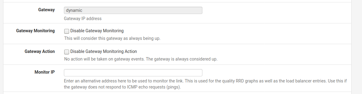

        @Bob-Dig
        I'd say this is the gateway monitoring status (the packet loss)
        The gateway prob doesnt answer to pings
        Tune here , or disable
        System --> Routing --> Gateways
