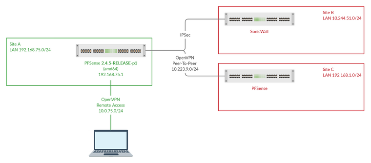

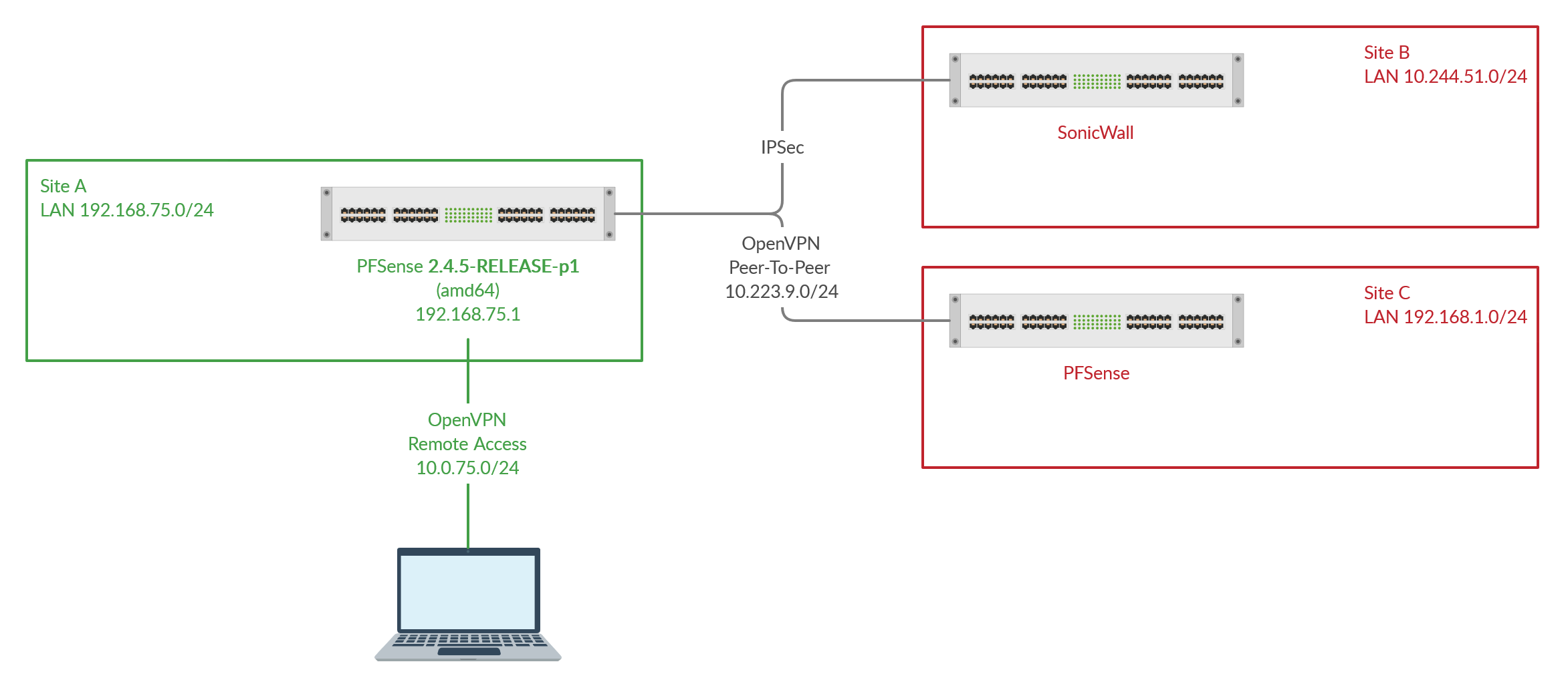

      I'd like to ask you for help on a topic I can't resolve. Let me show you a graphical represenation first and then explain the issue to you:
      The LAN of site A is connected with an IPSec-tunnel to site B and with an OpenVPN-tunnel to site C. Site B and C are marked red because I do not have any access to the routers there - site A is administrated by me (that's why it is marked green).
      Access from site A to both sites B and C works well without any issues.
      In addition there is a OpenVPN remote access from a laptop to my pfSense at site A also working perfectly fine with accessing all devices at site A.
      The issue:
      I would like to access sites B and C from the laptop connected to site A via OpenVPN remote access. Therefore I already pushed the routes to the client adapting the configuration like this (sorry for the german language - the screenshot shows the tunnel-network is 10.75.0.0/24 and the local networks are the networks from the sites A, B and C):
      After establishing the connection I see the proper entries in the routing table of the windows-laptop and if I'm trying to traceroute to a server e.g. at site B, I already see on the client that it is forwarded to the gateway at 10.75.0.1 (the OpenVPN-server on my pfSense) - so far it seems to work. However, after this point I already tried several approaches but did not succeed - please let me share my thoughts:
      • As I cannot access/change configurations at the sites B and C I guess I need to NAT the traffic to both sites coming from my 10.75.0.0/24 network so that they look like coming from 192.168.75.0/24

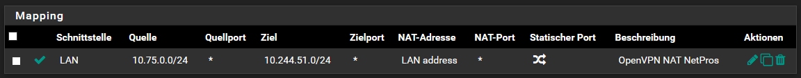

        I'm not 100% certain the Hybrid NAT will do what you want, I'd try Manual NAT instead with these entries:
        Interface = LAN
        Source Network = OpenVPN subnet
        Destination Network = SITE B
        Translation Address = Interface address
        Repeat the config for SITE C.
        The result is that it will do a NAT hide behind the LAN IP of the pfSense at SITE A when you are accessing SITE B or SITE C.

          I went through it and created the following outgoing NAT-rule for site B:
          Unfortunatelly this does not do the trick... 🤔

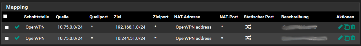

                  I adapted/added the rules as suggested:

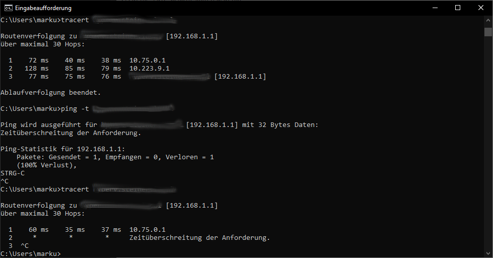

                  With the first try for a ping I thought "Resolved!" but I was too fast... there are two issues:
                  • The forward into the other OpenVPN tunnel (Site C) seems to work after the reload of the rules for some time... then it suddenly stops (please see the image below). I checked the logs for issues with the firewall but there everything seems to be okay (what sounds logical to me because why should it work immediatelly after the reload of the rules...?)
                    The first traceroute works as expected. A ping afterwards does not work for whatever reason (but the states of pfsense show a connection!) and another traceroute delivers a different result - the OpenVPN server at site A is still reached whereas the one at site C is not anymore... do you have any idea what could cause this issue? 🤔
                  • The outgoing NAT for the site B does not work at all... and I also checked the logs for firewall-rules blocking it... nothing... I can't imagine that there is a difference between NATting to an OpenVPN or an IPSec-tunnel... as we are already on a IP-routing level... or am I wrong? 🤔
                  I appreciate any comment as I am totally confused... 😕

                    @brma said in Accessing multiple LANs with OpenVPN remote access:
                    Possilby an asymmetric routing issue.

                    Basically I'd suggest to assign an interface to the site-to-site OpenVPN. Then move the firewall rule for this connection to the new interface tab and also change interface in the outbound NAT rule.
                    Did you restart the box at site A? Outbound NAT often only works properly after rebooting pfSense.
                    As I stated above, I don't think that will work for IPSec. However, the outbound NAT rule for site B is added to the OpenVPN interface (group). That won't work at all.

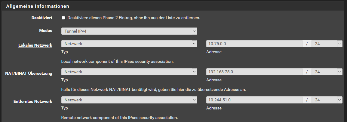

                          @viragomann: Thank you! I was able to resolve the issue!
                          For all having a similar problem, here is the solution:

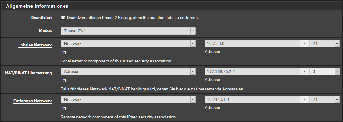

                          IPSec phase-2 configuration
                          First a phase two-entry needs to be created having the OpenVPN tunnel network as local network, the LAN network (which is the source network in the other IPSec phase-2 entry) as NAT/BINAT translation network and the IPSec target network.

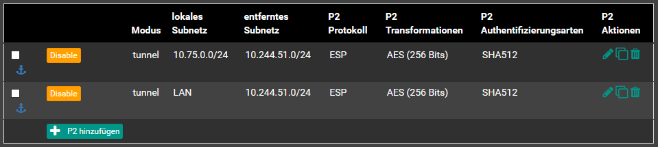

                          Next this entry must be placed before the original phase-2 entry so that the natting takes place before:
                          IPSec phase-2 configuration order

                            viragomann @brma
                            @brma
                            Consider that this setting translates the whole VPN tunnel network to your LAN network. So if the VPN client has the virtual IP 10.75.0.2 it is translated to 192.168.75.2, hence a LAN device using this translation IP cannot communicate with the remote network.
                            Therefore I suggested to use the PAT mode, where you pick an IP out of your LAN network which is not in use and set the translation to this single IP.
                            Concurrent connections between multiple VPN clients and the remote network will work anyway in that mode.
                            • B Offline
                              brma
                              @viragomann: another very valuable hint - thank you!
                              I adapted the configuration accordingly:
                              I also limited the ip-range of the DHCP-server to make sure this address cannot be assigned to anybody else.
