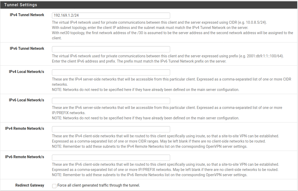

      • I have an OpenVPN server with the tunnel network set to 192.168.100.0/24... All good here - clients can connect without any problem. Nothing is set in server's advanced options

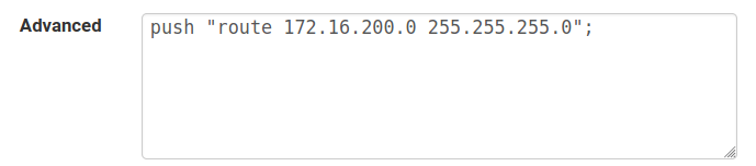

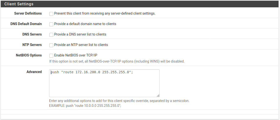

      • I have an CSC entry for one CN which overrides IPv4 tunnel network to the address ```
      and has in Advanced options:
      After I connect to VPN server with that name - I get the proper IP assigned

      • RicoR Offline
        Rico LAYER 8 Rebel Alliance
        Completely borked what you are doing there.
        "With subnet topology, enter the client IP address and the subnet mask must match the IPv4 Tunnel Network on the server."

          CapitanBlack
          @CapitanBlack said in Client Specific Override and route push:
          192.168.100.0/24
          I'll try to explain what I'm trying to achieve (not what's wrong!):
          As said above I have a Remote Access (SSL+Auth) OpenVPN server with IPv4 tunnel network 192.168.100.0/24 it's config is pretty basic - all clients connects to it without any issues. The "IPv4 Local network(s)" parameter is set to an empty string. Nothing is set in Advanced field.
          I have two VPN users who must get IP's from two different tunnel /24 networks when connected to this VPN server, e.g:
          • user1 - gets .2 IP from tunnel network: 192.169.1.0/24
          • user2 - gets .2 IP from tunnel network: 192.169.2.0/24
          (this part works well - see the CSO exception below)
          Then I use OpenVPN PBR firewall rules to route these subnets to two virtual interfaces, eg.
          For all packets from 192.169.1.0/24 gateway is GW1 (192.168.130.1/24)
          For all packets from 192.169.2.0/24 gateway is GW2 (192.168.140.1/24)
          (this part works well too)
          These above gateways are actually two separate Ubiquiti routers. Each of them has a physical interface with the subnet 172.16.200.0/24 and few bare metal hosts in it. The router1 has a "return" static route for 192.169.1.0/24 and router2 has a "return" static route for 192.169.2.0/24.
          The ultimate goal I have is to allow these two VPN users accessing hosts in their respective 172.16.200.0/24 networks
          E.g. both users must be able to reach the IP 172.16.200.5 but each user communicates with its own respective bare metal host.
          Makes sense?
          • RicoR Offline
            Still does not make any sense to me to use IPs outside the tunnel net. Those 192.169... addresses are not even RFC1918.
            Whats the problem with using fixed addresses INSIDE the server tunnel net and policy route traffic out a different gateway with Firewall Rules?

                CapitanBlack @CapitanBlack
                RFC1918.
                Thanks bro. it's working now. I misunderstood the:
                I read it as - "network can be any but netmask must match"
