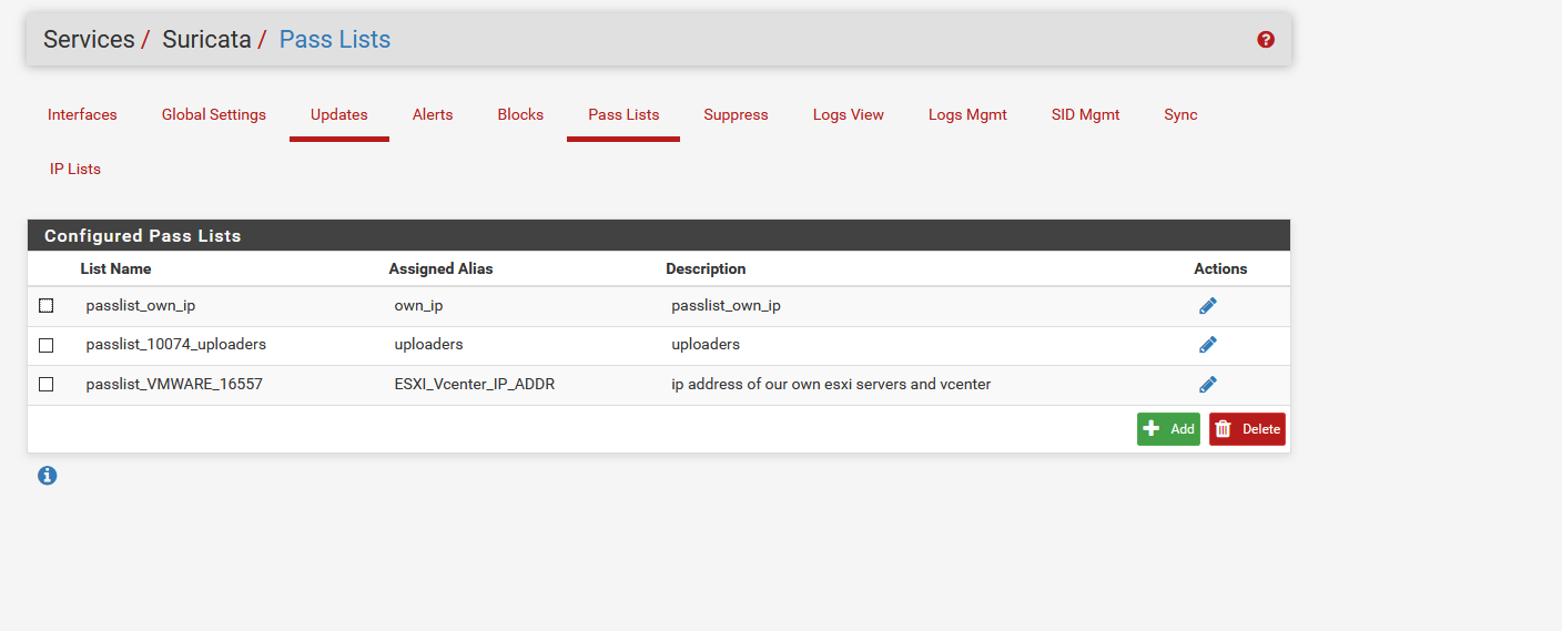

      Hello , I hope you doing well .
      the pass list that I have been added trough pfsense for suricata , will not add in suricata config file so all of the alerts will trigger on the ip addresses that I have been added in the pass list
      please tell me what can I do about it ?
      step to reporduce :
      create a pass list
      restart suricata
      now go to the shell and look at the config file of suricata :
      ps -aux | grep suricata
      now cat the config file and grep for pass_list
      go and see the content ๐Ÿ˜ƒ
      please help
      Thanks .

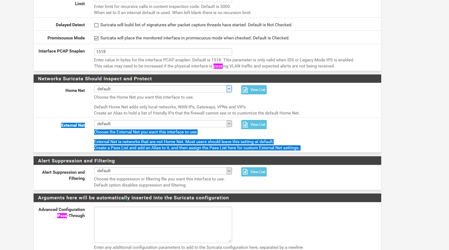

              @bmeeks Thanks for your reply , as I saw there is not Pass list section in the interface tab .
              There is an "External Net" with this description :
              "Choose the External Net you want this interface to use.
              External Net is networks that are not Home Net. Most users should leave this setting at default.
              Create a Pass List and add an Alias to it, and then assign the Pass List here for custom External Net settings. "
              is is the one that you said shoud be set that the pass list take affect ?
              • SteveITSS Offline
                SteveITS Rebel Alliance @lovidi6842
                @lovidi6842 if you have Block Offenders unchecked then the Pass List option isnโ€™t shown as itโ€™s irrelevant.
                Upvote ๐Ÿ‘ helpful posts!
                • L Offline
                  lovidi6842 @SteveITS
                  @teamits Thanks you <3
                  • bmeeksB Offline
                    bmeeks @lovidi6842
                    @lovidi6842 said in Pass list is not working in Suricata on PFSENSE ( latest version ):
                    Or, if you have Inline IPS Mode enabled, there is no Pass List option then as it is not used in that mode. For Inline IPS blocking, you need to create your own Custom Rules with the PASS action. But in reality the Pass List function is really not needed with Inline IPS Mode.
