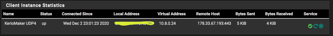

      Hi, so I recently set up an OpenVPN connection. the connection itself is successful.

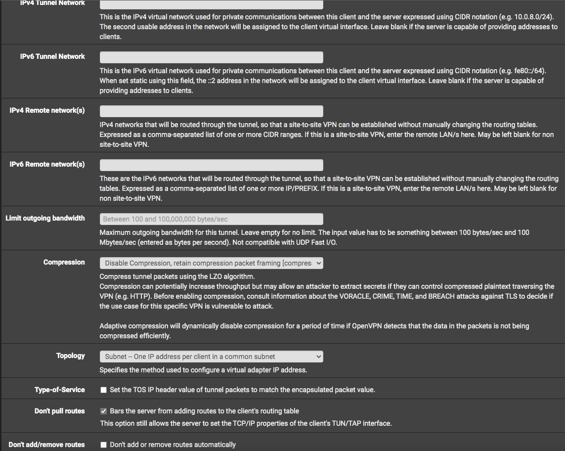

      here are my OVPN Tunnel settings edb0dc1d-fe99-4a05-bcf0-1edf9a50566c-image.png
      I was instructed by my provider to check dont pull routes I unchecked that, but then it completely broke my main internet connection (WAN). nothing was accessible.

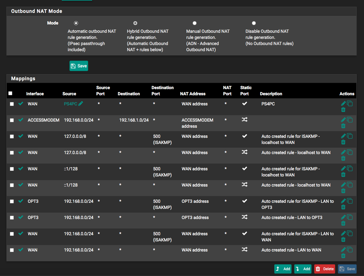

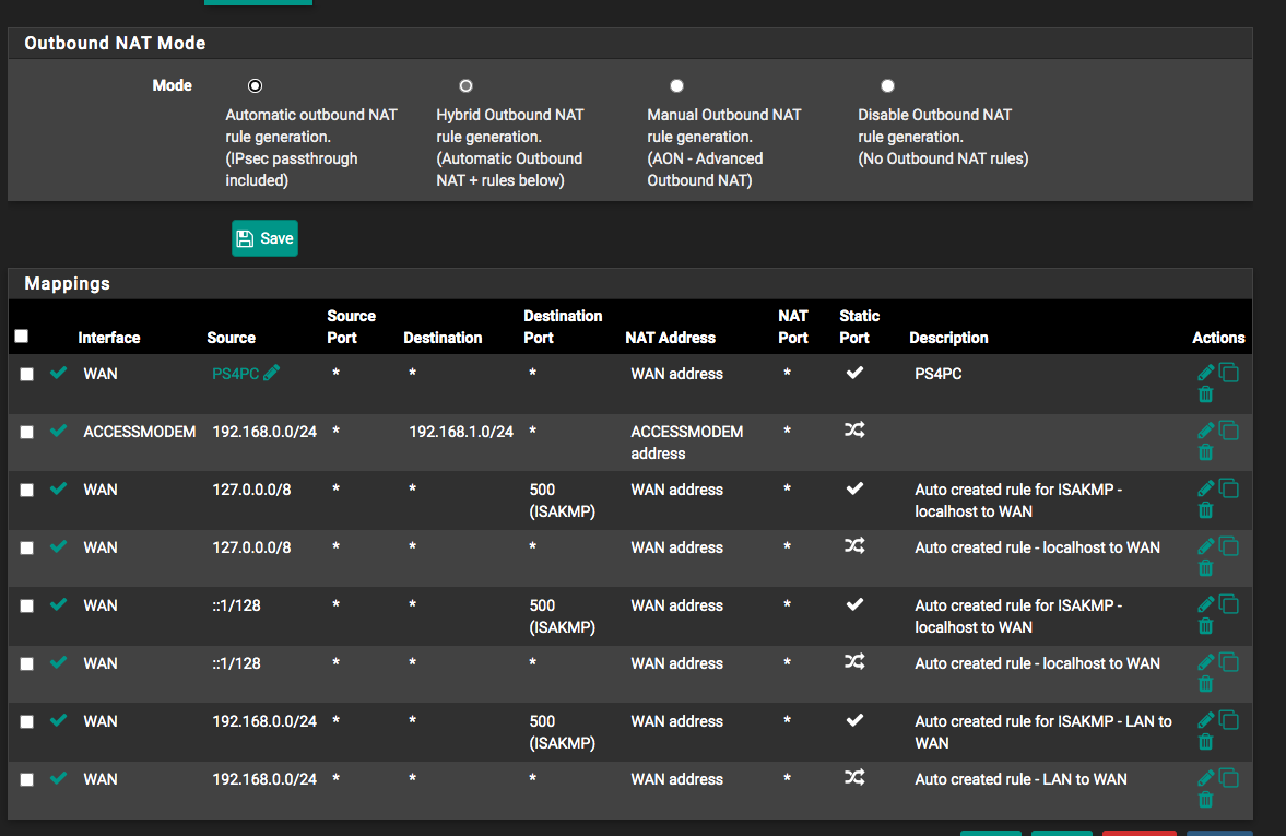

          only specific, I used to do this with plain L2TP, but I figured OVPN would be safer, and faster in my experience.3b67fba3-e658-451e-a7a4-3dfb77a18d95-image.png here are my NAT rules (the first one is for the PS4, second one is for accessing the modem, not relevant)
          do I need to just duplicate all of the auto created rules and set their interface to OpenVPN? is that what you mean?

            The last two rules may for the source of LAN network. Copy these and change the interface to OPT3 which you have assigned to the VPN.
            To get the ping tool work to a public IP as you tried above, you also need a rule with the source 127.0.0.0/8 (pfSense itself). However, you may also need to route that public IP over the VPN.
            Since you only want to direct specific traffic over it, you may have to check "Don't pull routes" and add policy routing firewall rules to the LAN.

              So I copied the LAN to WAN rules and changed them to OPT3, also tried to pay attention to the order of the rules. I made a firewall rule that redirects all traffic from my laptop to the OPT3 (ovpn) gateway.(ignoring the ping utility issue for now) it didn't work,i.e everything times out. I don't see any blocks in firewall logs.
