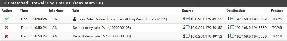

        What are you wanting to fix.. your blocks are duplicate RST.. Ie that IP telling that other IP to F off.

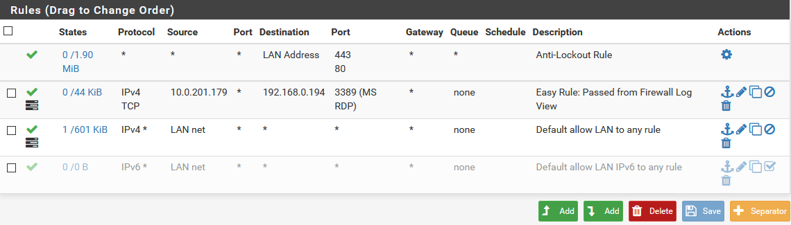

        Your allow rule there is pointless anyway since you have an any any rule.. Also RDP can and does and wants to use UDP as well..
        Once a state is closed, then yeah you send more RST, they would be blocked.

            Your any any rule there would allow the traffic.. But its not going to allow more RST after the first 1 closes the states.

                Open up the sniff in wireshark so you can easy read what is going on.. Once a RST is sent and the state is terminated.. Then yes further traffic would be blocked because its out of state..
                When you see blocks of anything other than S.. the traffic is out of state..

                                        For anyone looking in the future: the pfSense firewall showed a block entry in the firewall log for what we think was an out of state packet meaning the data was being sent at a time that it should not have been.
                                        In our case, the block entry in the log was confusing because pfSense was not actually blocking the RDP connection itself. Rather, the thin client was misconfigured in a unique way that would only work if directly connected to our main network. The thin client's RDP connection would fail (and pfSense would show the block) only when the thin client was connected to the bespoke hardware pfSense router and it was connected back to us over IPSEC VPN. (just in case it helps anyone else, our thin client had its own MTU setting which need to be set lower than that on the pfSense WAN but ours is a bit of a unique case)
                                        In short, if you have a case where the "Default deny rule IPv4" seems to override your allow rules it probably means the device sending data is misconfigured. Exactly how it's wrong will depend on the device.

                                            Glad you got it sorted.. Can just delete this whole thread if you want. But should leave something showing the R in the log, and how that is just pfsense blocking what is out of state traffic, etc.
                                            Unless you see S on the log, it means the traffic is out of state for whatever reason.. And yeah that will be blocked by any stateful firewall ;)
