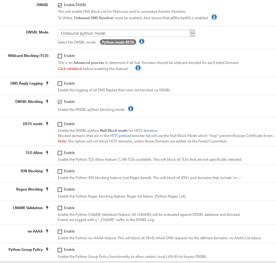

Disable IDN Blocking
can't turn off IDN blocking.
option is unchecked.

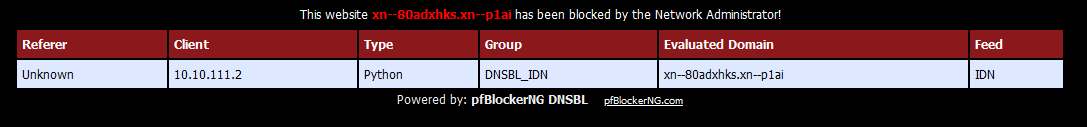

if i disable all DNSBL groups in the settings, then IDNs are not blocked.
if i enable at least one group even with one address (not IDN), then all IDNs are blockedand the problem is with python mode only

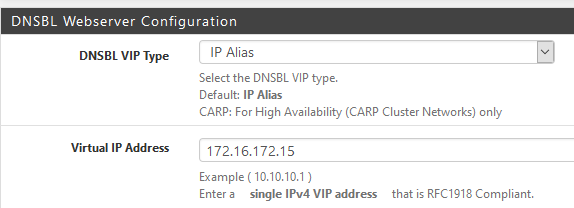

other pfsense instance have the same problemfor example IDN - xn--80adxhks.xn--p1ai
it resolves to the address 172.16.172.15

HSTS disabled, IDN Blocking disabled
HSTS disabled, IDN Blocking enabled
HSTS enabled, IDN Blocking disabled
HSTS enabled, IDN Blocking enabledForce Update, Force Reload All, Force Cron...

I made several requests to xn--80adxhks.xn--p1ai -
