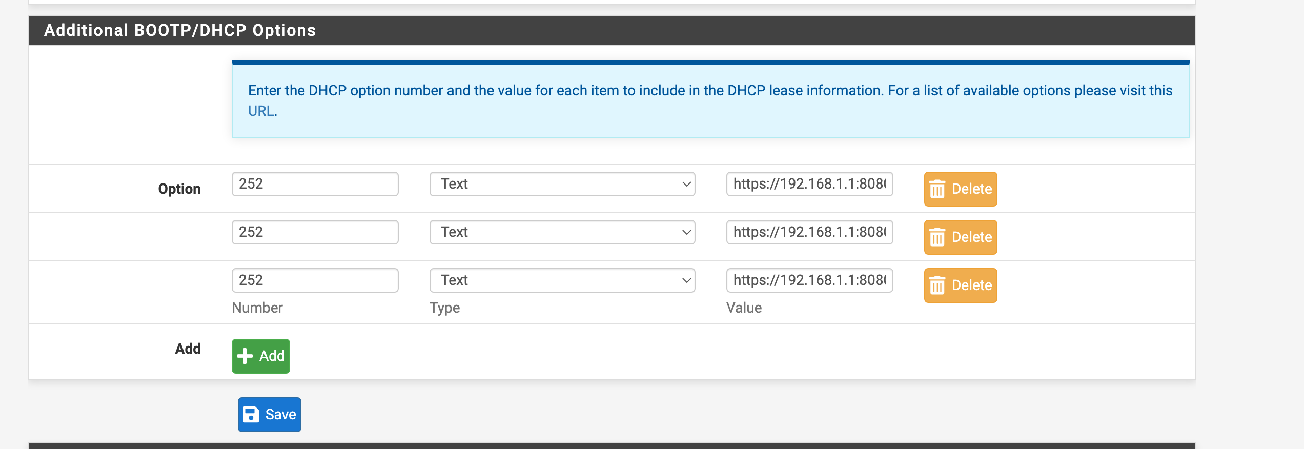

                                    @proggggger Another fix to issues with devices that have no option to configure a proxy is to configure DHCP option 252
                                    This hands the proxy out also when it hands out the dhcp ip addresses. Make sure you have the proxy set up on wpad for this to work.
                                    Example:
                                    https://192.168.1.1:8080/wpad.dat
                                    is handed out with the dhcp address again if your wpad is set up to also hand out the dns server this fixes a lot of issues.
