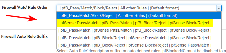

      Wouldn't Shouldn't this work?
      Or would that put any any above pfb block?
      I am not a fan really of any sort of "auto" rules.. I just use pfblocker for alias managment.. And then manually use those aliases in rules I create..
      You could put your allow to pfsense for dns rule in floating, while pfb rules on interface(s)

        The instructions read
        Select the 'Order' of the Rules
         Selecting 'original format', sets pfBlockerNG rules at the top of the Firewall TAB.
         Selecting any other 'Order' will re-order all the rules to the format indicated!
        I interpret that has reordering all my pfsense rules. I have my rules in the order they must be executed and putting all my pfsense pass rules before pfsense reject rules will not work.
        It seems that the only way out is to disable/delete the faulty blacklist until this is fixed. There should be an easier way, mistakes can happen.

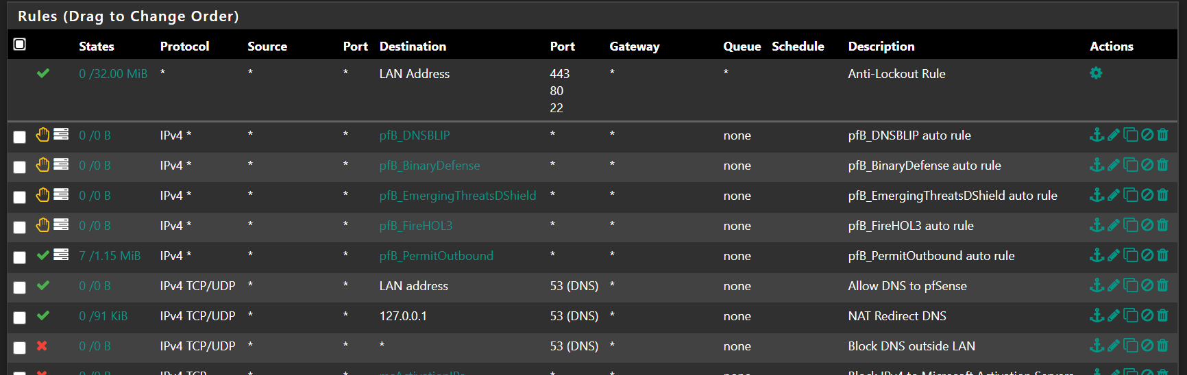

            @bbcan177 I may just be dense here but I do not see how this changes thing. To illustrate my problem, please see the following rules
            pfB_DNSBLIP contains the 192.168.1.1 IP which I need to allow. I am allowing this in pfB_PermitOutbound, which is however executed after pfB_DNSBLIP. If I move pfB_PermitOutbound to the top, everything works fine, but the pfBlockerNG update process recreates the rules and original order, thus preventing 192.168.1.1 to pass. This problem seems to be the same whether I define 192.168.1.1 as an alias or put it in a custom list set to "Permit Outbound".
            Am I thinking about this wrong?
