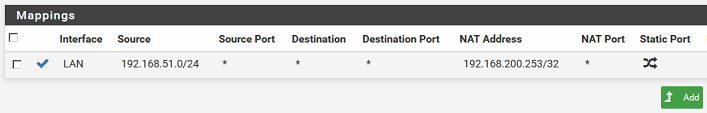

          2, defining a NAT outboud rule on pfsense1:
          The unwanted aftermath was that the whole traffic between the networks was allowed and I had to design some extra block rulesets to allow only what I really need. But in the end nothing hard.
