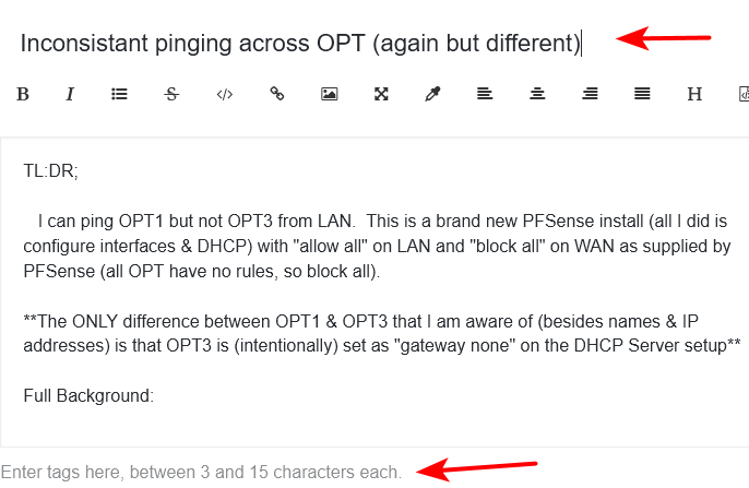

      coatmaker618
      TL:DR;

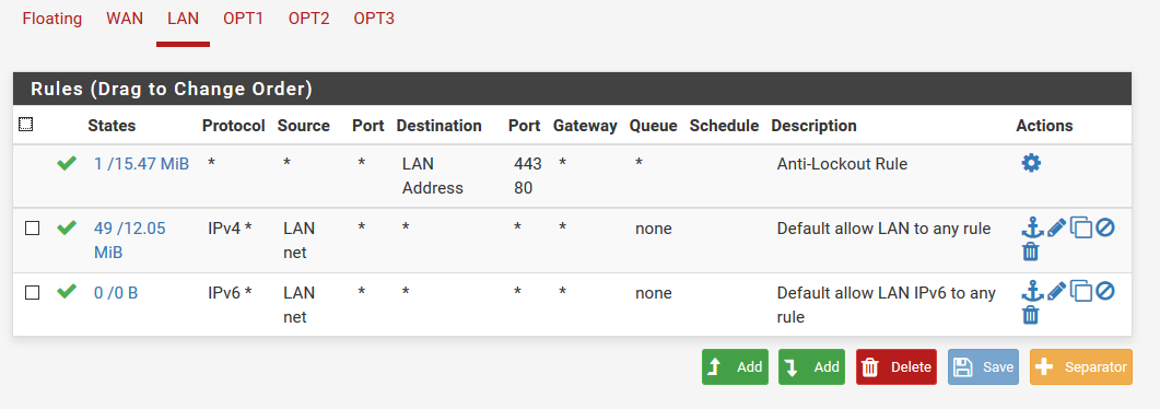

      I can ping OPT1 but not OPT3 from LAN. This is a brand new PFSense install (all I did is configure interfaces & DHCP) with "allow all" on LAN and "block all" on WAN as supplied by PFSense (all OPT have no rules, so block all).
      The ONLY difference between OPT1 & OPT3 that I am aware of (besides names & IP addresses) is that OPT3 is (intentionally) set as "gateway none" on the DHCP Server setup

      My firewall rules are default (no floating rules)
