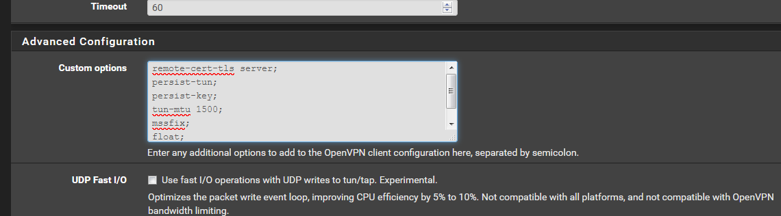

@ancjr Did you use semicolons as it says at the bottom?
My config looks like this
And works with no issues
@netblues That would be the issue. It is strange that the entire config worked without the semicolons until I added those lines. Nevertheless, it appears to be working normally now. Thanks.
