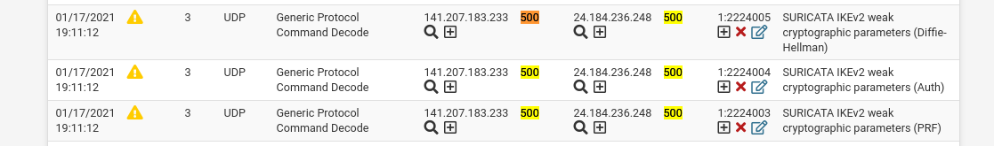

      With IPS in Legacy mode, and 'Block on DROP only checked', I'm allowing everything to happen and just logging what would have been blocked.
      So things like Verizon's wifi calling (vpn) would have been blocked.. ebc9f1ca-a8f1-4c8d-b337-60f6e8d3ca48-image.png
      So what I'm looking for is 2224005, which is in the Active Rules.. but I thought the Active Rules came from the choices on WAN Categories.. (which I don't see where 2224005 is..)
      SO, if I could have anything I would like to enable the IPS, and be able to just flag on these Suricata protocol violations.. but have the ET SCAN and ET DROP actually blocked/dropped.. but be able to choose the Suricata violations that I would like to start block/drop..

        Let's start first with answering your question about the Protocol rule. That rule is coming from the set of built-in Suricata rules that are part of the base package. I forget exactly what the name of that category is at the moment, but if you look under the RULES tab at the list of categories in the drop-down selector you will find some that have "Events" in the name. Those are the built-in Suricata rules. They always get enabled by default. You can suppress that particular rule alert, or you can completely disable that rule SID. Click the red X under the GID:SID column to disable the rule, or click the plus (+) sign to add it to a Suppress List.
