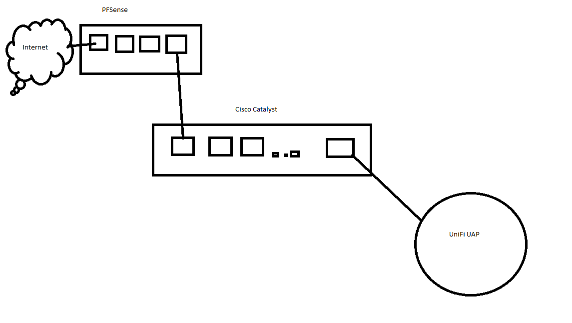

I've got my PFSense box connected to an old Cisco Catalyst, connected to an old UniFi UAP:

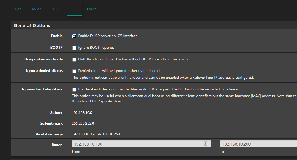

Each VLAN has it's own DHCP Server:

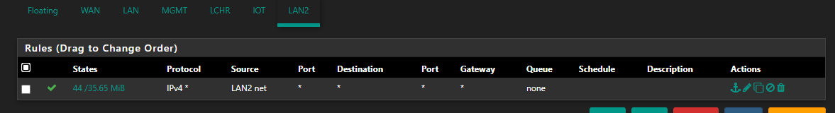

LAN2 has the same rules as all the VLANs and it works just fine:

@apathia Either post all your rules, or put an any source to any destination allow on all interfaces.
(or temporarily disable filtering all together)

@johnpoz Here's a super basic image of my actual network:
I do I have VLAN99/LAN2 (RE1) connected to G0/2 on the Cisco switch and F0/2 connected to the AP (or my laptop when I'm testing whether DHCP works or not).I think that answers your questions? Everything is wired up correctly, LAN2 is only active because it's the only interface in Pfsense I can get to work.
