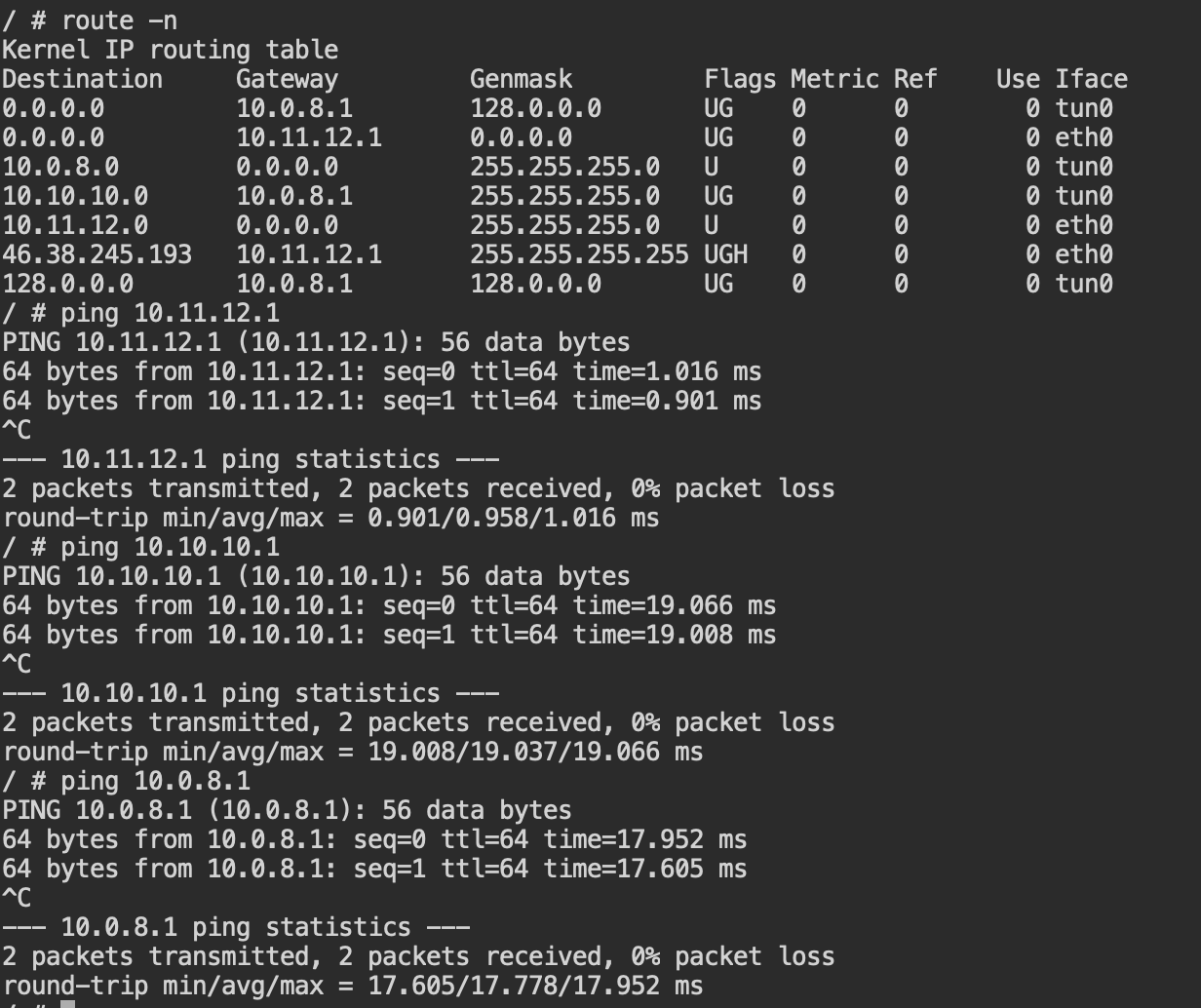

      Screenshot from the client side:

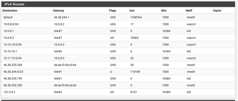

      Routes on pfSense:
      What am i missing?

        This way i was able to set the vpn nic as opt1 on the interface tab. otherwise i could not set any static routes.
        You should not add static routes for device behind a VPN. This should be done by OpenVPN itself by adding your home local networks to the remote networks in the OpenVPN settings.

          the static routes are a result of my 2 day long testing.. there is no difference when i push the routes through the openvpn config

              @marvosa the client has enabled ip forwarding. routing tables on both sides look fine for me too. the client can ping the whole setup. there must be one little checkbox im missing that stops pfSense from routing to the client network.

                Yeah, the routes to your home LAN my work, but it is not ideal to set static routes. Instead you should use the Remote Networks box in OpenVPN.
                However, so the request packets destined to your LAN are directed over the VPN and may reach the LAN devices, but latter will send responses to their default gateway, but not back to Unraid. That's why the default gateway should be the VPN endpoint at all.
                If you want to get it work this way, you need to do masquerading on the Unraid on packets destined to your home LAN, so that it translate the source addresses in packets going to LAN devices into its LAN address. Only this ensures that responses are coming back.
