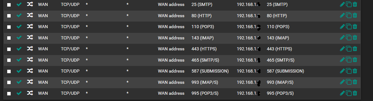

      I've a newly set up pfsense box with an existing iredmail mailserver behind it. Port forwarding and automatic firewall rules created. My phone can connect to the mailserver from outside the firewall and send/receive emails. The webmail interface is accessible from outside, but not from inside unless I use the IP address. Outlook (inside) says it connects, but is unable to send/receive. When there was just the old Asus router, I was able to connect using the FQDN and it allowed webmail, outlook, and phone from both inside and outside.
      Any ideas?
      Bueller?
      Port Forwarding:
      Firewall Rules: WAN
