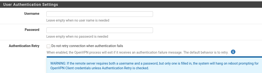

            see https://redmine.pfsense.org/issues/10409
            and https://redmine.pfsense.org/issues/3633
            P 1 Reply Last reply Reply Quote 1

              @viktor_g thank you very much. That explains it.
