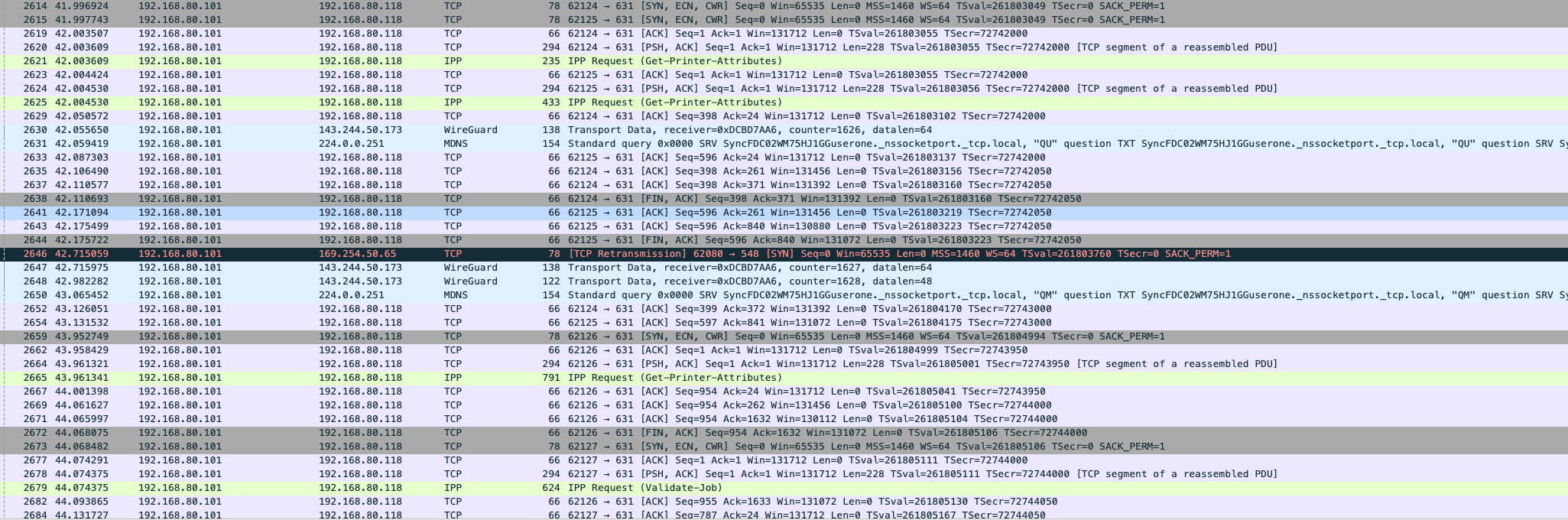

          @jknott I do happen to have a Wireshark capture. I don't have enough experience yet to analyze exactly what it is saying. There is more history to the capture than what I have posted, but here are 2 different spots.
          Thank you for your help!
            Please upload the actual capture. It contains a lot more info than a screen capture.

                        Here is the full capture. Sorry in advance if it is too much info, but I don't have the knowledge on what to filter and how, so that those of you that are helping only get what you need.

                          Ok looking at it for 2 seconds.. Can say yeah your sending traffic to your gateway that you shouldn't
                          You can see the mac of where your sending the data, is not the mac of the .118 box
                          And that is the mac of your gateway. See where your sending traffic to what is clearly not your network the 143.244 address - its going to your gateway..
                          Let me comb through it a bit more.. But yeah the redirect is clearly sent - why your sending traffic to 80.1 when your trying to talk to 80.118 which should be on your network..
                          Can we see the output of your ipconfig to validate mask..
                          J J 2 Replies Last reply Jan 27, 2021, 5:42 PM Reply Quote 0

                            Why do you have traffic going to 1337
                            https://www.speedguide.net/port.php?port=1337
                            That wireshark is saying is wireguard? Are you using some a vpn client on this .101 box?

                                  I also see a redirect, in packet 451, coming from the gateway, which means the original packet is being sent to it. According to the message, the source was 192.168.80.101 and the destination .118. The packet in 450 shows a destination IP of .118, but the MAC shows the gateway. So, that means the sending device thinks the destination is off the local network and so is forwarding packets for it via the gateway.
