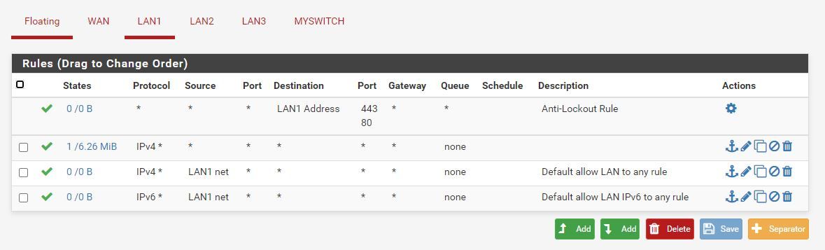

                My LAN1(igb1) Firewall > Rules:
                LAN1(igb1) Firewall > Rules in the video:
                Everything is exactly the same, also the MySwitch(bridge0) rules.
