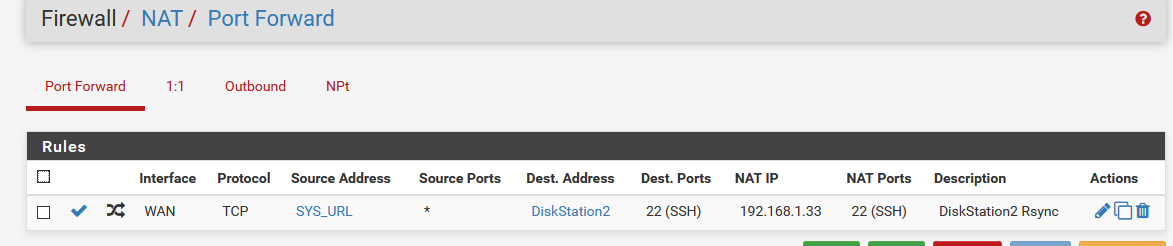

                I have a NAS on my LAN, let call it 'diskstation2', IPv4 = 192.168.1.33.
                I have a NAT firewall rule on pfSense :
                I have a web server, using server IP's (and related host names or FQDN's) somewhere on the Internet.
                The access to this NAS is source limited to the alias "SYS_URL", which is my server on the net (last pass rule on WAN interface ) :
                These host names ( FQDN) don't mean nothing to a firewall, it's the "300" second background resolvers process that take care of things.
