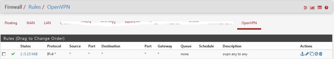

          What is (are) the OPENVPN firewall rules ?
          IPv4 * * * * * * none ovpn any to any

            Gertjan @ToXaNSK
            @toxansk said in Open VPN no access to http/https/ssh/samba, etc.:
            Hummm.
            A gateway set for the OpenVPN server ?

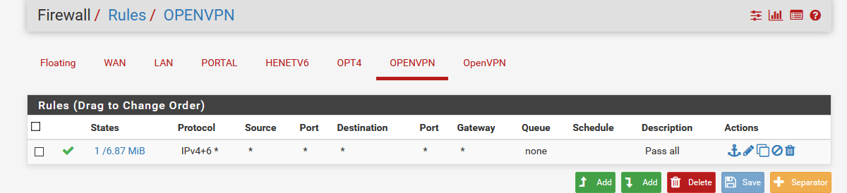

              This
              Tell me, is it necessary to create an interface from a OPT interface?
              In the manuals, we are simply talking about OpenVPN.

                Gertjan @ToXaNSK
                Noop.
                'OPTx' is the default name of interface that are found and assigned by you.
                A router (firewall) needs to have two interfaces at least.
                Other interfaces can be phyical NICs and used as other LAN's other WAN's or they can be VLAN (LAN's over LANs) or virtual interfaces like the OpenVPN interface that is created when you start a OpenVPN server.
                • T Offline
                  ToXaNSK @Gertjan
                  @gertjan Thanks for the link to the channel. I will definitely see everything.
                  You have two interfaces.
                  OPENVPN
                  OpenVPN
                  do they both need them to work correctly?
