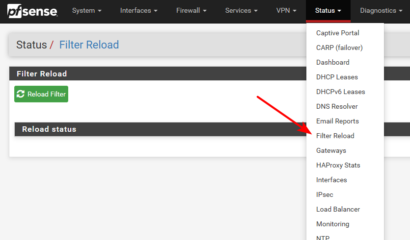

        Did you actually reload the rules?
        You can always force that with.
        And watch status that they actually reload.. You can always debug rule via looking at the rules.debug
        cat /tmp/rules.debug

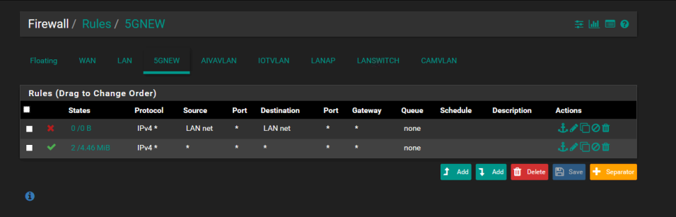

          This is a fresh install so only one rule on every interface which was allow all. All protocols. The block LANnet rule was added so I could test rule making. Disabling or deleting doesn;t seem to remove it. I can't ping anything on LAN and I can't even ping PfSense itself.

              Well that rule would never trigger on the 5gnew net.. Since source would never be lan net..
              So it would never do anything.. Notice the 0/0 - means it was never even evaluated.
              If you have the default any any rule and you can not get to lan net devices - the number one issue with this is firewall rule on your device on lan your trying to get to.
              Can you ping pfsense 5gnew IP? Can you ping lan IP of psfense?
              If you can not ping pfsense 5gnew IP from 5gnew device - you sure your even on 5gnew? Clearly you have some traffic hitting this any any rule, and currently 5 states open on this rule.

                Sorry for the picture, I remade the rule to demonstrate after deleting, and didn't plug in the right source.
                I can ping the DHCP server for 5GNEW, but not the PfSense gateway. I will go home tonight and wire everything into a proper switch and have all interfaces (VLAN, LAN) coming off the LAN port on the router.
                The dummy bridge I was talking about in the other post has been removed for all this troubleshooting.
                And no, no floating rules. Firewalls are also disabled on each PC I am trying to ping to from LAN to 5GNEW.
