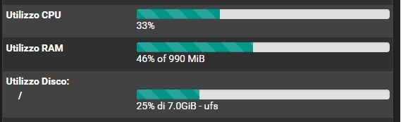

I made freshclam update in the tab in real time it gives me an error, I also tried to change the region from europe to canada and the clamav service as you can see from the screenshoot does not start.
I'm not running out of memory until 60% is tolerable
Question in Select customer information to forward to ClamAV what should I enter?
But do you have to activate the users?
Help me start the clam also because I have the premium subscription I still have this and pfbloker who is helping me a guy in the other post and then finally I can start working with customers thanks -

That's just the key. There is no error, none of your packages show as red or yellow.
@antonio-briguglio said in Problems with configuring ClamAV Anti-Virus Integration Using C-ICAP on squid proxy server.:
What is the error?
That is not supported.
You realise that clamav can only scan traffic that is proxied? Your setup is only proxying http traffic. So any traffic that is https will not be scanned. Which is like 95% of all web traffic.
ClamAV really does almost nothing. You should just disable it.
Even if you do get this running it's going to run very badly on the SG-1100. You should be running something like the SG-5100 to cope with all those large packages.
