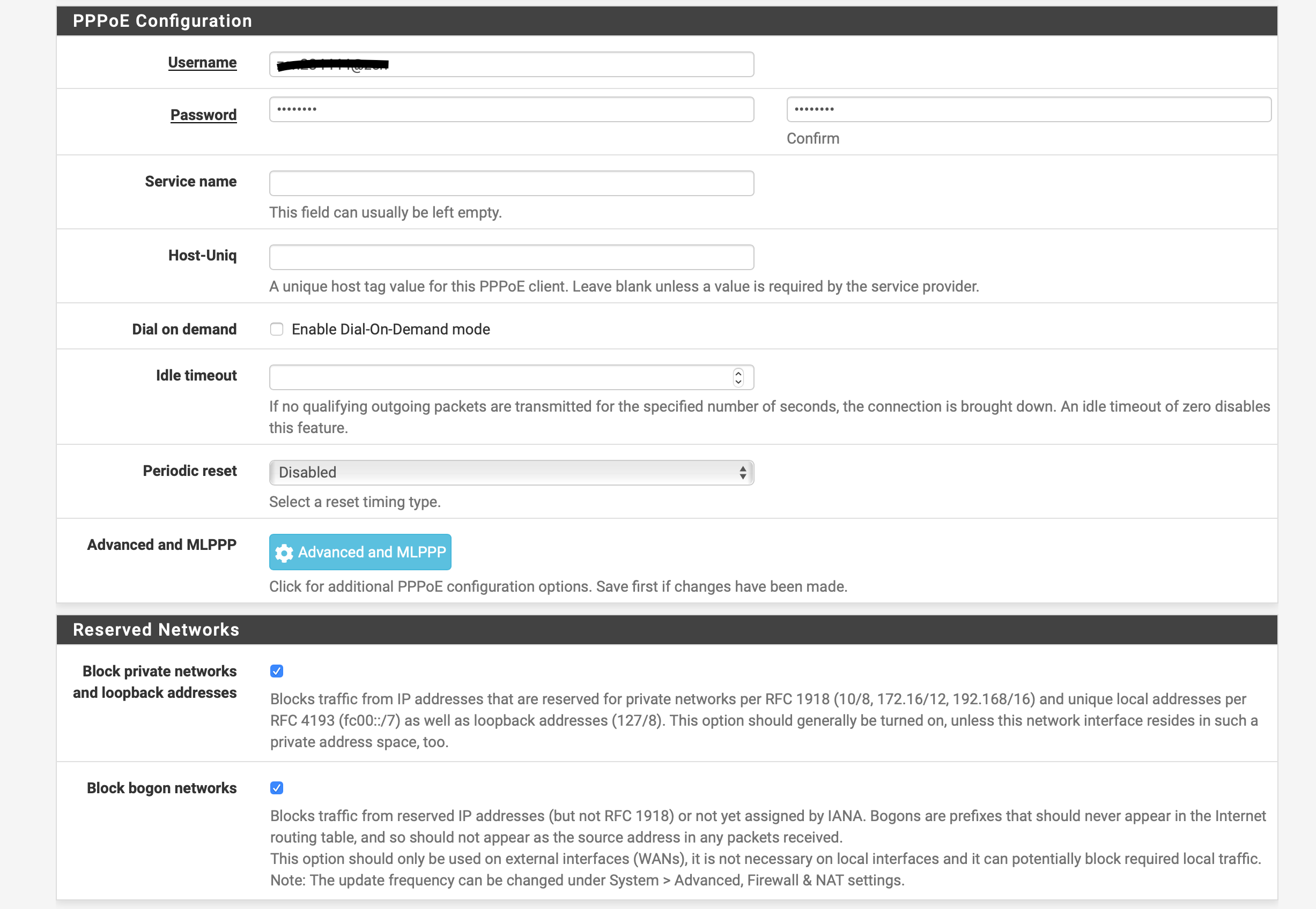

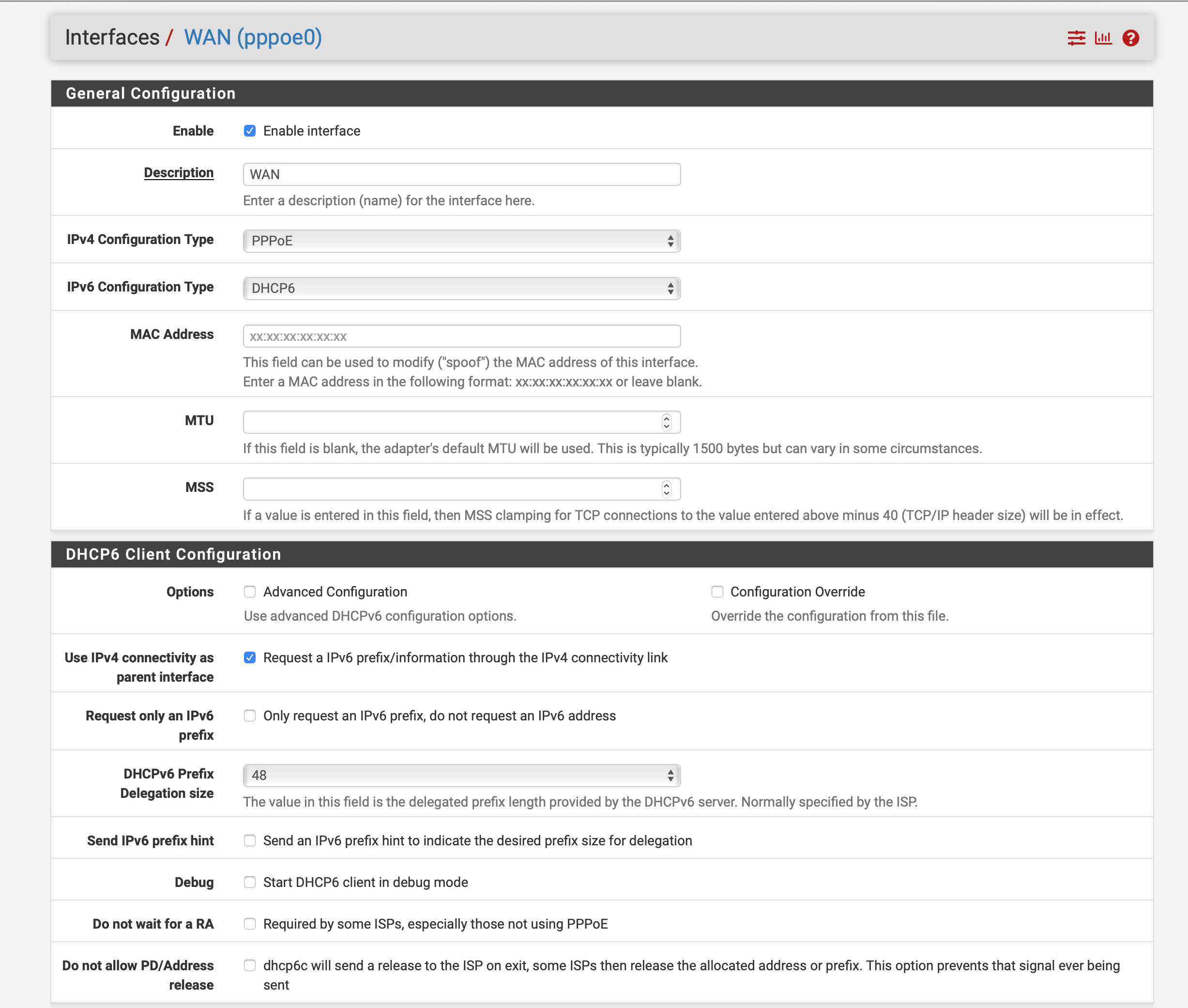

            WAN settings

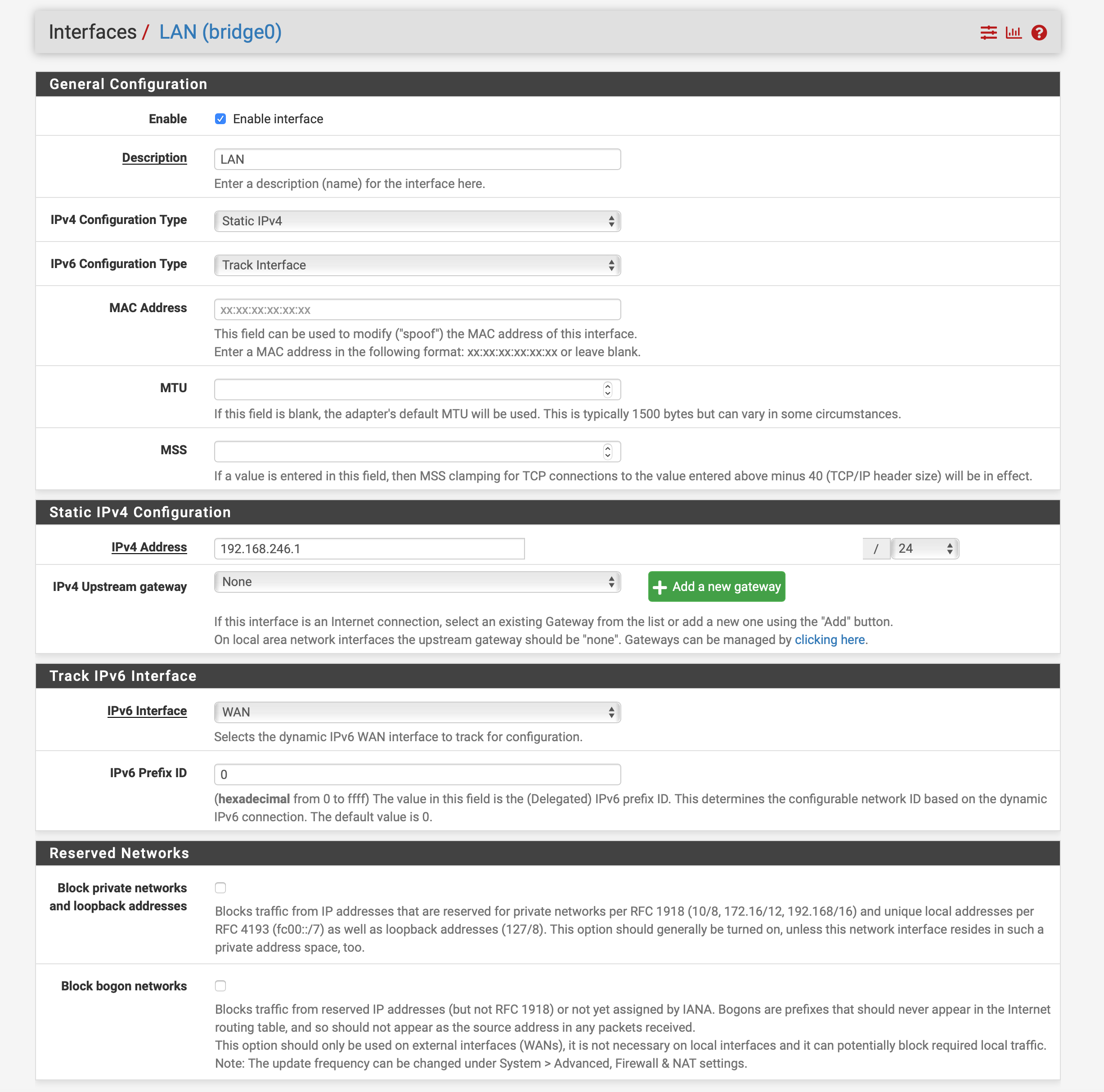

            LAN settings (I actually have two ports bridged - I know that this is frowned upon, but I don't need the speed and although I have a switch that I could use the extra box and plug would make me unpopular at home)
